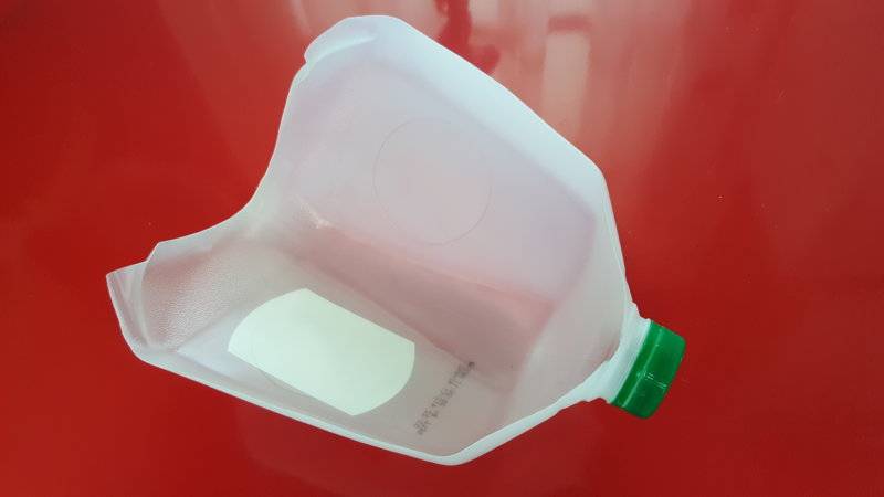

While were on the subject, here's a catch can that you can make out of a gallon jug.

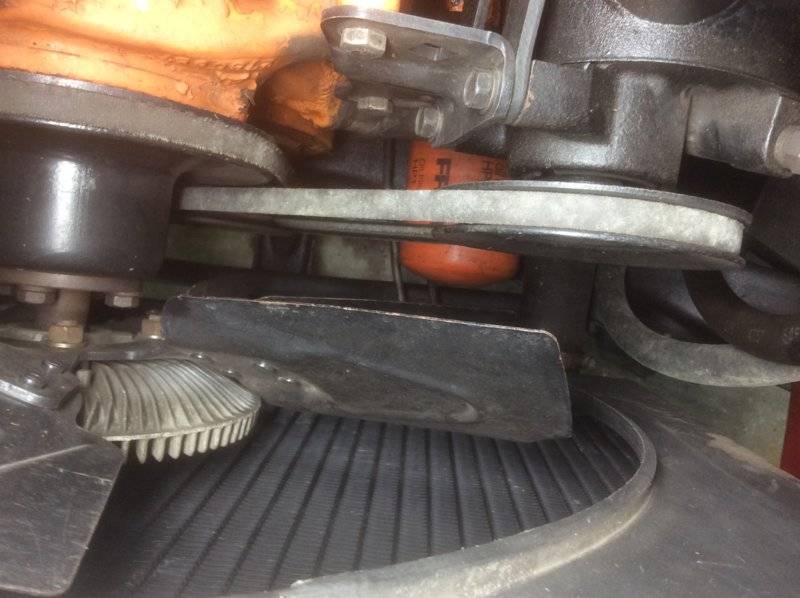

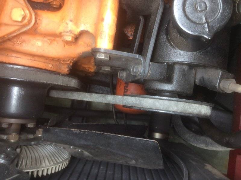

Pictures of 66. Note sway bar! My routing of cooler lines below filter. Sway bar is the problem. MO.
