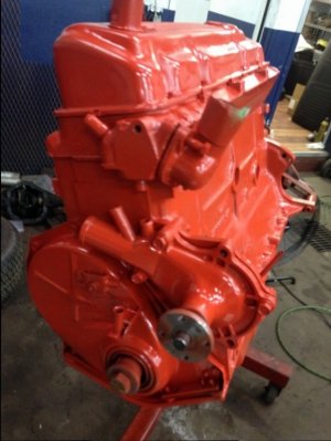

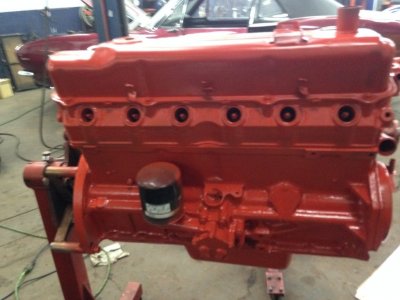

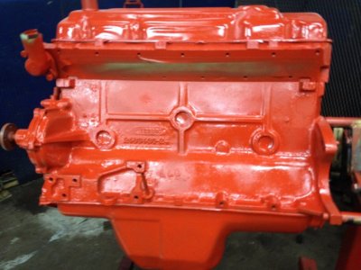

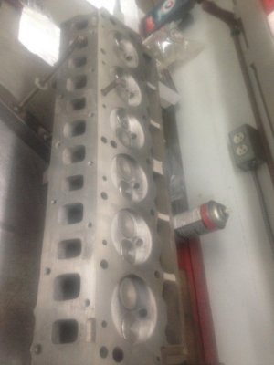

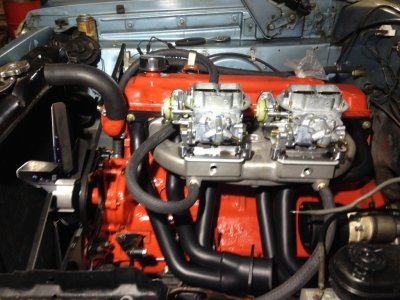

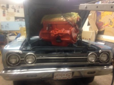

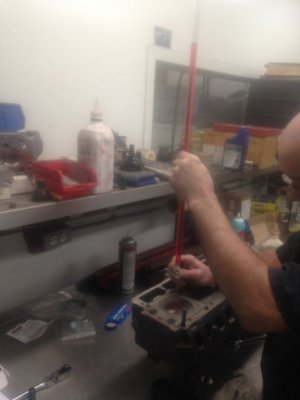

just put the bottom end together , and installed double roller timing chain.shaved head .100

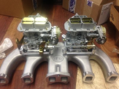

cc'd the head and block . 9.1 compression , 268 solid cam. twin carbs webbers and headers
heres the short block

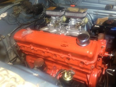

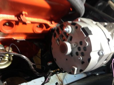

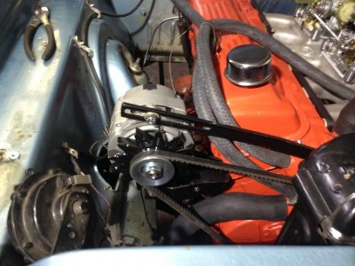

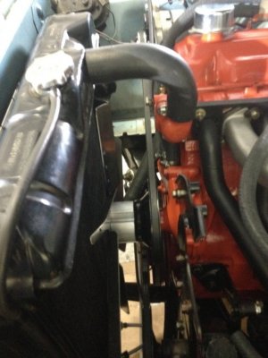

i got the the alternator form a the local rebuilder , a delco ,one wire pos to batt . i used the bracket from the dodge diplomat and it lined right up . i just made a spacer for the lower pivot bolt and its fine
next weekend going to rewire it and get the distributor in .hopefully soon will tow it back to my shop and make the exhaust system .

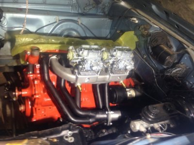

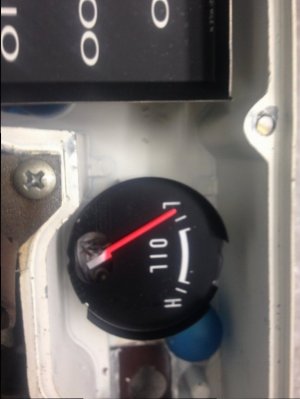

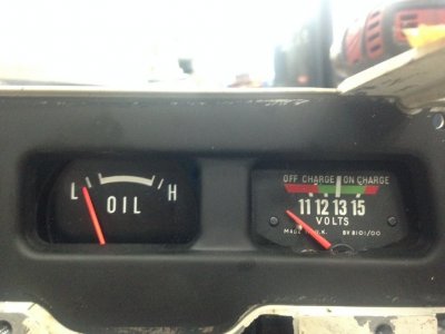

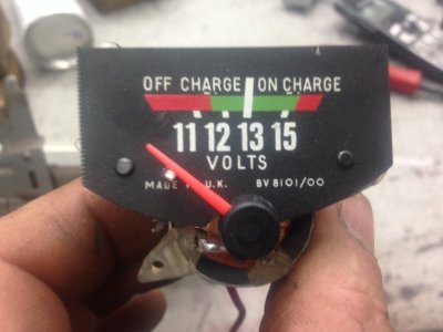

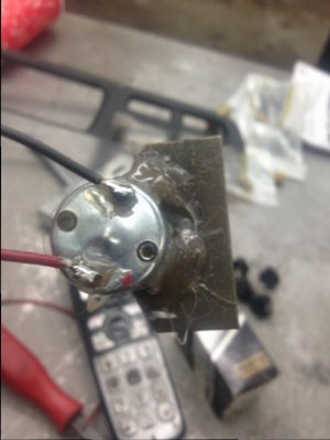

I found a ford oil ps gauge that fit where the amp meter went, and removed the oil light and installed
(with great difficulty) a voltmeter in it s place
so now I have full gauge dash

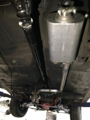

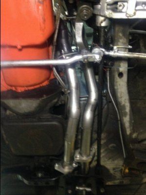

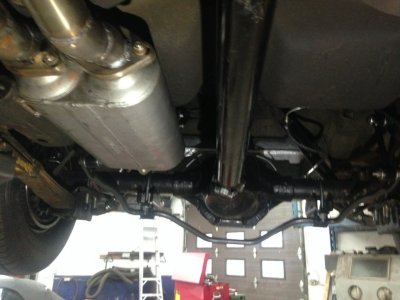

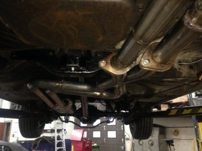

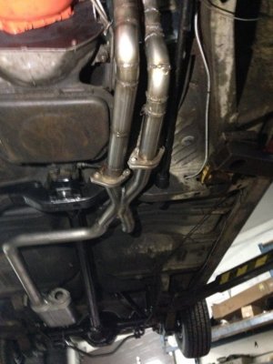

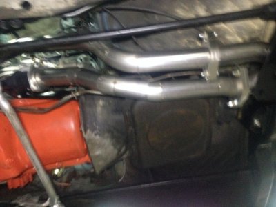

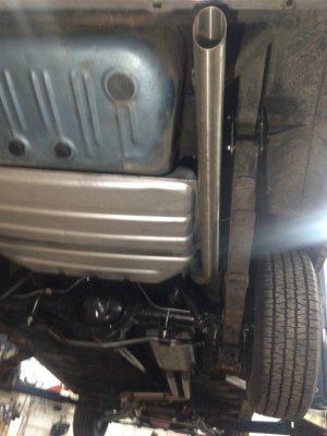

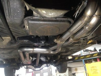

started the exhaust getting some more stainless pipe next week. i'm going to break in the engine with the front pipe on then replace it and add 2 racing cats to keep it smelling nice out the back , long gone are the days of good gas,the last of it here was sunoco super it smelled so sweet and didn't stink

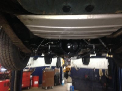

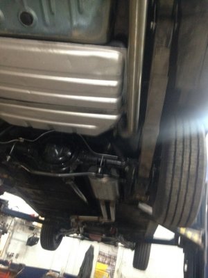

the exhaust is done , now to get the linkage done for the kick down and then starter her up
