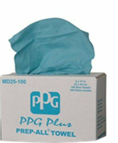

I purchase glass quart bottles of wax/grease remover, pour into a spray bottle, and use the auto body shop prep towels to final clean almost everything. The blue towels do not redeposit the oil, grease, wax, and grime. I believe these are different than the blue paper towel rolls you find at AutoZone, etc.
