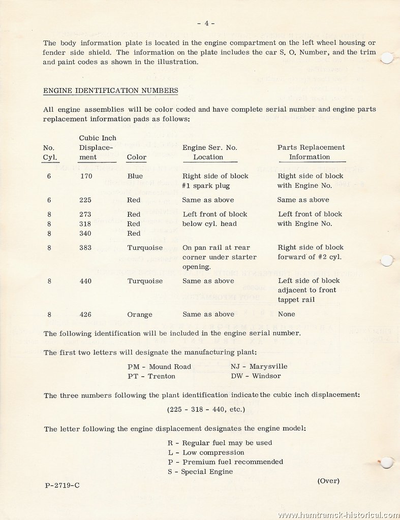

What color was engines in 1968 Sport Satellites, and Roadrunners?
prhousejr
5:35 AM
May 9, 2009
352
7
city
1968 225 Six All Red Mopar Paint P4349218
1968 273 V8 - LA All Red Mopar Paint P4349218
1968 318 V8 - LA All Red Mopar Paint P4349218
1968 318 V8 - LA - Police only Police engine H-Orange Mopar Paint P4349216
1968 340 V8 - LA All Red Mopar Paint P4349218
1968 383 V8 All Turquoise Mopar Paint P4120752
1968 383 V8 High Perf/Police High Perf H-Orange Mopar Paint P4349216
1968 426 HEMI Street Engine H-Orange Mopar Paint P4349216
1968 426 V8 All Turquoise Mopar Paint P4120752
1968 440 V8 All Turquoise Mopar Paint P4120752
1968 440 V8 High Perf/Police High Perf H-Orange Mopar Paint P4349216

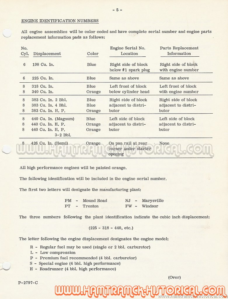

I'm not so sure that info is all that correct.
Can't speek for anything except the '68 383 and 440.
Turquoise on both cases regardless weather it's a HP or not.
Orange didn't go on the 383 and 440 HP till the '69 production year.
Just my .002
Can't speak for anything except the '68 383 and 440.
Turquoise on both cases regardless whether it's a HP or not.
I agree.
There are A LOT of mistakes on that list. One of the problems with copying and pasting from a site is you run the risk of perpetuating wrong information.

I can only speak to one year. I bought a 1967 GTX brand new. I had the high performance 440 and it was turquoise not orange as stated above.

I agree with 69Runner , lets get all the facts right and edit the list.
I have personally seen two 1969 models , both with High Performance engine painted Turquoise , one was a 383 Magnum the other a 440 Magnum, but both were very early build cars, the 69 383 Bee had a 9/26/68 build date and the 69 Charger R/T had a 9/19/68 build date.
I once heard that Orange wasn't used till 1/01/1969, but I can't validate this statement, Do we have any old timers that worked for Chrysler back in the day on here that can help with this ?

Every 1969 318 that I have ever seen was Red.
