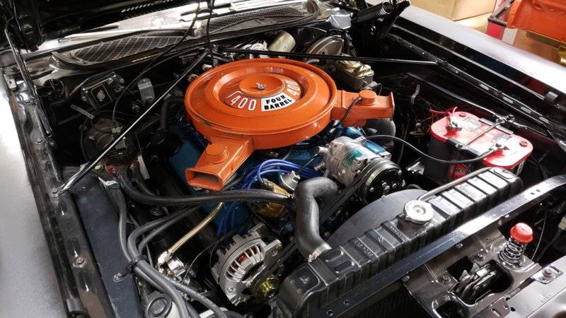

These are original '72s, note the slight bend in the pass side strut and at the outer ends of both struts.

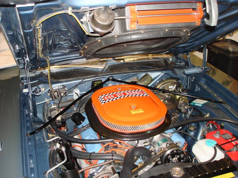

These are later '73 & up modified to fit a '72. the outer holes re-drilled for shorter dimensions and outer bends were added, needed for hood hinge clearance, both sides. I didn't bother with the air cleaner bend, not needed for the non-A/G car.
