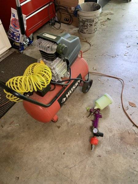

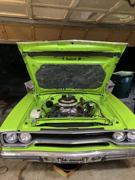

I want to finish painting my engine bay, hood hinges, and bottom of hood Saturday with a harbor Freight Tools hvlp $19 gun and 8 gallon compressor. I have a water filter for it too. If I reduce it 2:1, will it paint ok in short bursts? I used custom mixed aerosol cans for the front areas but they are pricey at $28 each. Doesn’t have to be perfect.
Hi,
The most important thing is to have at least 50' between the compressor and water trap/filter. It can be a length of air hose.This gives the water vapor time to cool and condense. The trick is to spray paint on the surface and not into the air. Lower pressure with an HVLP gun will help. Practice on a large piece of cardboard to get the air and fluid adjustments right. After you have the right settings, let the compressor charge up and then cool off. The sound should be sort of a "woosh" not a loud "hiss".

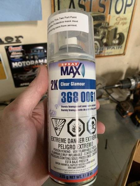

I will. Using Limco base coat and 2 part clear in a spray can. It came out awesome in the area around the hood latch.

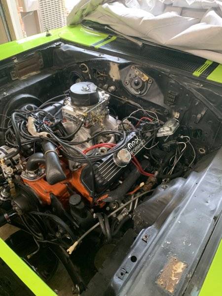

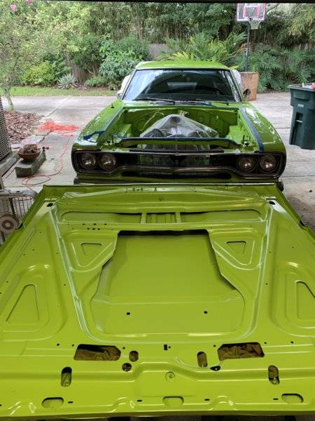

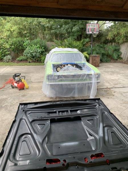

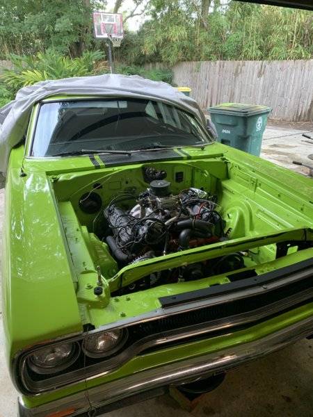

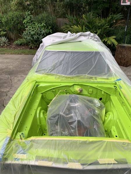

Thanks for all the tips. That could not have gone better except for a few water drops here and there. I’ll just touch those up later. The 8 gallon compressor never lost pressure and the harbor Freight Tools $19 sprayer was money!
Nice job masking. That turned out great and with the engine sitting in there to boot.
Looks real good !:thumbsup:
Looks nice and made a huge difference. Time will tell but again looks great.
Finished product.

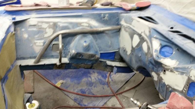

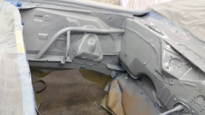

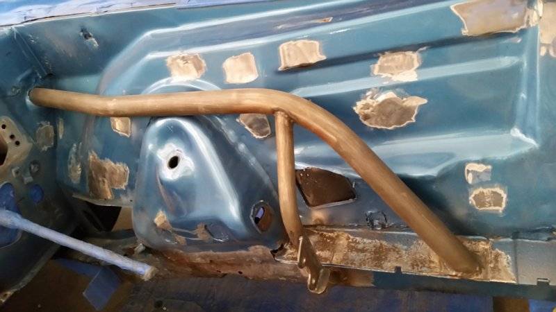

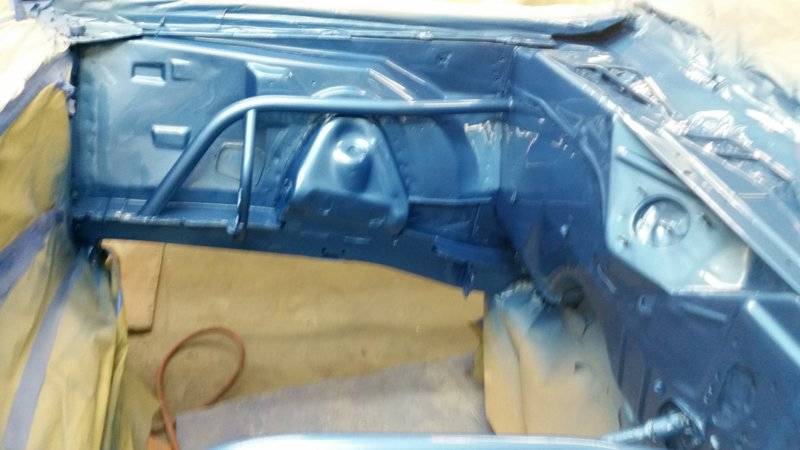

Did this very thing on my Challenger repainting the engine bay after welding up all the holes and the raw steel tubing for the snout bars from my cage which also support the front plate.
