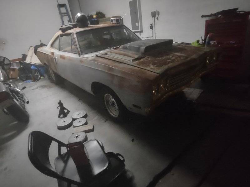

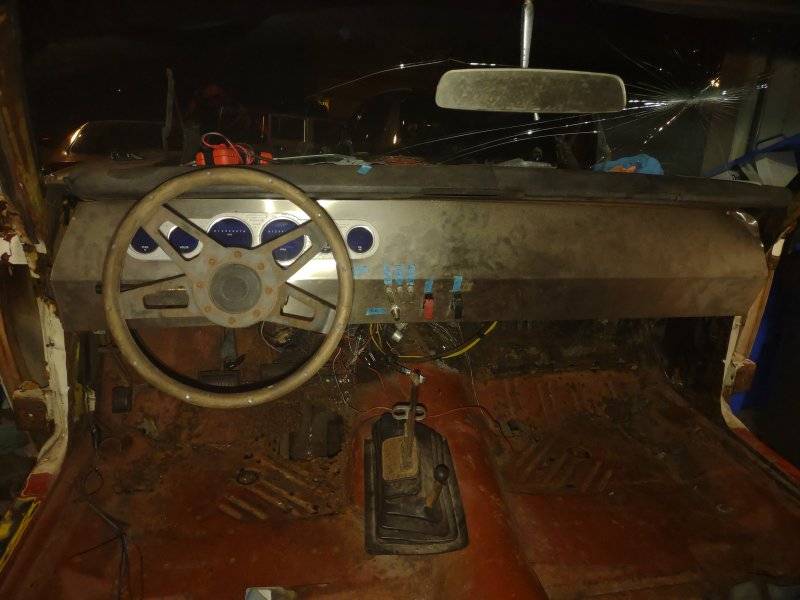

The exterior and interior will tell you what to you. How much work? Also, what do you want in a classic car?
Got any pics?

Got any pics?
I don't particularly care if it's original since nothing really is original anyhow, and it needs a lot of work.
