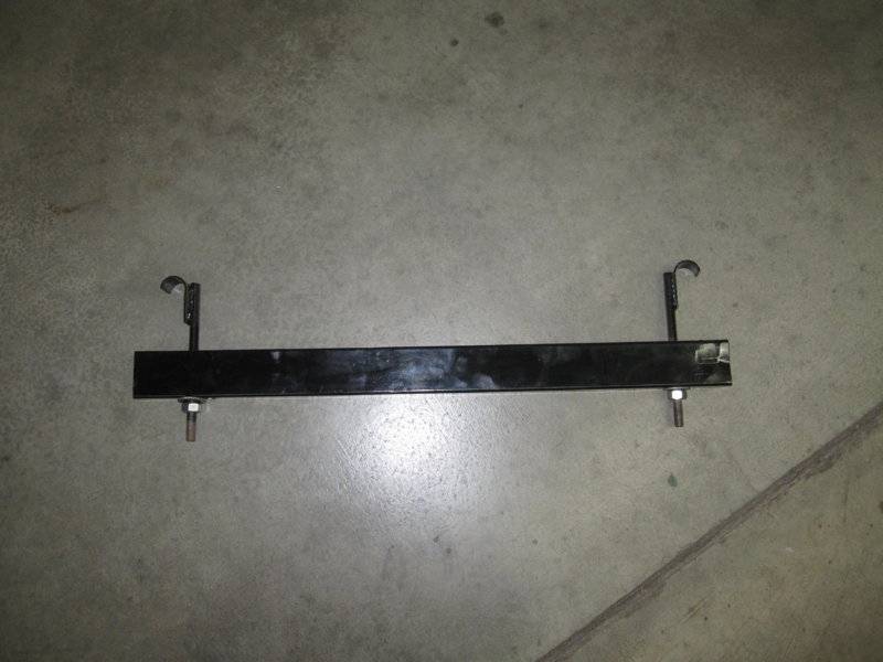

I built this light weight tubing support years ago. Hangs off the torsion bars, height adjustable. Just put under the oil pan.

The design I created in post #6 would work with a wood 2x4 as well.

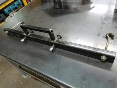

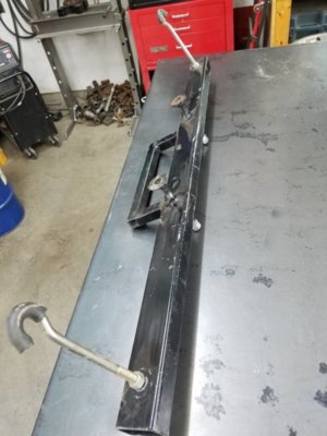

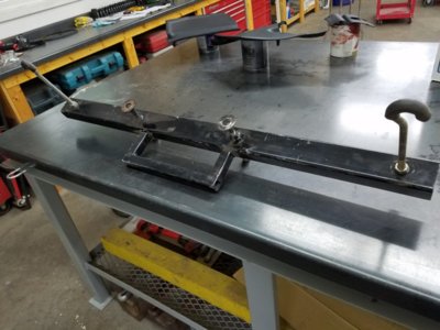

I made this a few years ago. Hooks up on the frame rails.
