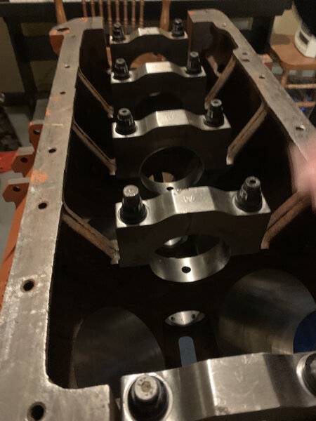

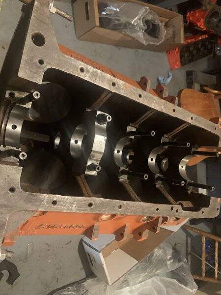

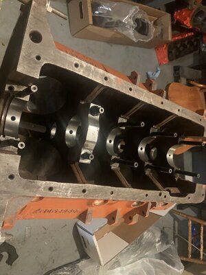

We got 440 source studs that for some reason had a stud sticking up or the guy at the machine shop didnt torque wrench it properly…
So I don’t understand yet and haven’t taken it out in thr below picture because we are reading the line bore gaps first to make sure the bearings are correct..

I never torque studs in my motors just double nut and run down with arp grease hand. Snug .
Install bearings crank and caps .

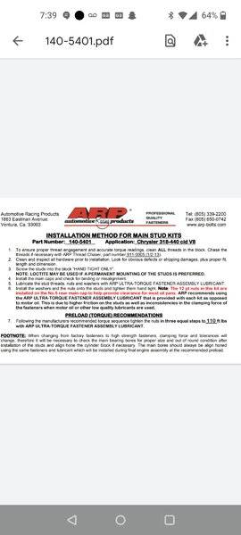

The nuts should be tourqe to ARP spec.
The studs shouldn’t be torqued or bottomed out. Apply assembly lube and screw the studs in hand tight then back them off a 1/4 turn and proceed.

Hey you do have to torque the bolts right just not bottom out the stud right??
Yes install the studs place the cap over the studs apply assembly lube to the stud threads and bottom of the nut and torque them.
