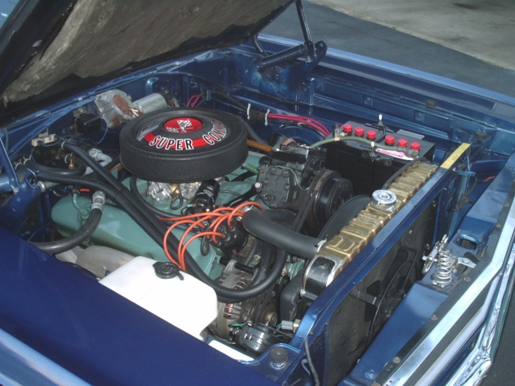

I used it from Summit, quite a bit cheaper thru Summit. I Just painted my 69 383 AC engine with it. Looks great.

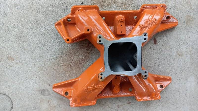

Sorry for stepping on your post, but I thought maybe you or the other posters might know if engine paint (looking for hemi orange) can be found in brush on paint in a can. I have use Por 15 on many parts and body parts. Don't skimp on your prep. I have used it with fiberglass to repair rusted floor pans. Great success, stronger than the steel and paintable itself.

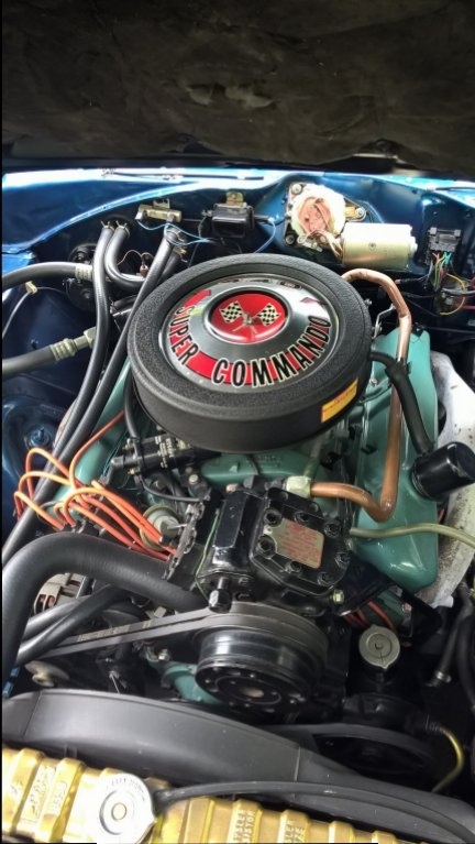

Yes, I used POR15 turquoise. 16 years ago and still looks great! Even where the exhaust manifold superheats on the passenger side, there are no burnt or browned section from the heat. I painted it with a brush while the engine was still in the car and it flowed out like it was sprayed. Make sure you go overboard in the cleaning process - that is the key. Even the RV2 AC compressor is POR15 black. The black did lose some gloss over time.

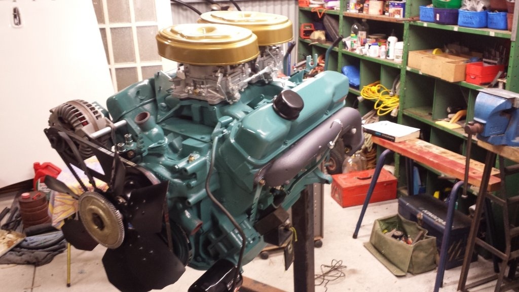

I used por15 turquoise and it is very high quality indeed! As said by others, no need to spray it as it flows so well off the brush.
