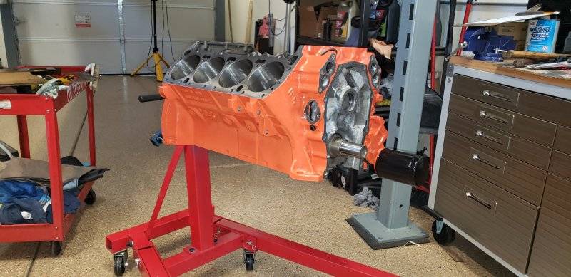

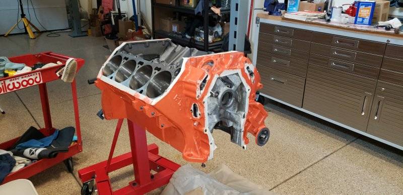

I painted my 440-495 with single stage acrylic enamel in GoManGo orange.
Self etch primer.
Regular primer.
Paint.

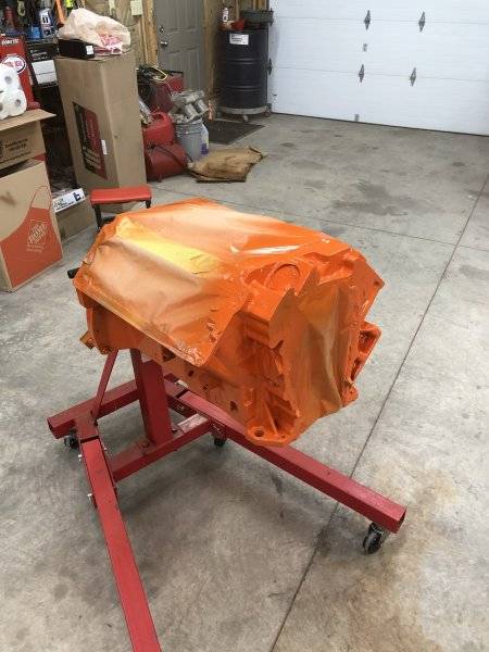

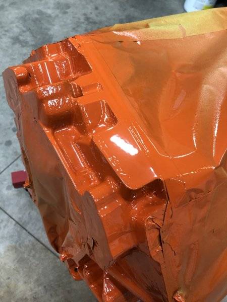

Done with the paint job. I think it cam out pretty good. I used the KBS cleaner, then the paint prep which is really an oxide coating, then brushed on the finish coat.
