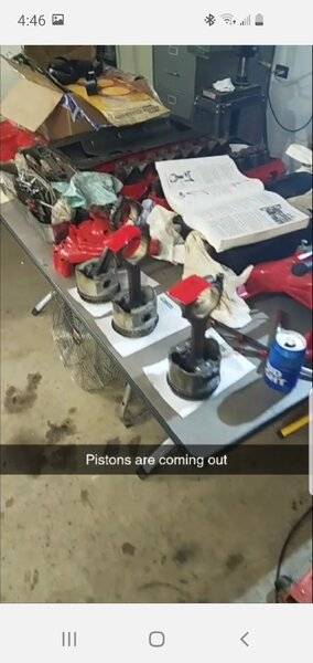

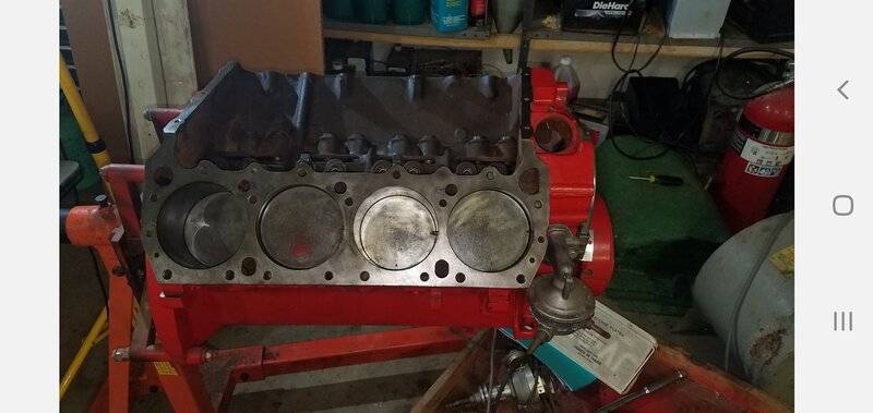

Heard loud and clear...swapping the pistons to their original cylinders. Everything came out and went in just as they were ment to, engine rotates flawlessly thanks everyone for the great advice.
