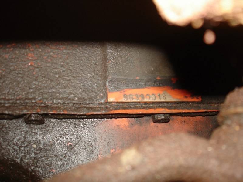

So I just pulled my 383 Engine out of my 68 Super Bee. I knew it wasn’t numbers matching, but would love to find out more about it….what it lived it’s life in before the Bee (it never ran in the Bee). What I do know (from casting numbers) is this…..a 383 cast on 7/9/70 at 7pm. Can’t find anything readable on the pad next to distributor. Passenger side pad stamped “1C(cross)17528”……how much, and where do I find anything else, to include that number,……?
On the passenger side oil pan rail will be a machined pad that will have the VIN... maybe. Some weren’t stamped.
A ‘70 cast block should have the number for the year of the car, the letter for the plant where the car was assembled, then the 6 digit sequence number.

So it went in a 71 something…..and just need to find out what factory was “C”. I think the Maltese cross has to do with undersized something….and the remainder is the serial number car / engine. Thanks for the help!!!
“C” would be Jefferson Ave. Motown. I had a ‘68 New Yorker that was built there.
Check the bottom of the block by the oil pan. That is where the VIN is. It’s on the passenger side on B/RB engines.
This is from a ‘69 Dodge Main “Hamtramck” built car
That’s where I got the number, passenger side pad above the oil pan. My car was built at Lynch Rd. Would be nice to see what this engine started in……Thanks for the info
Unfortunately unless the block is out of an early ‘69 MY car... which would have the full VIN. You will only know the factory. You can narrow that down to what cars were produced there.

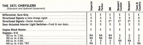

Jefferson built Chryslers and Imperials so it's from one of them.
A Newport or a New Yorker. Imperials had 440’s only.
I’m wrong. I forgot... New Yorkers were 440 only in ‘71. Funny thing though... a neighbor had a ‘71 Town and Country wagon. The 383 2Bbbl was standard in that barge.
So, Newport or Town and Country wagon. I’m not sure what else was made there in ‘70-‘71.
I think other C bodies might have been assembled there. If that’s the case then... Furys, Polaras, and Monacos.
