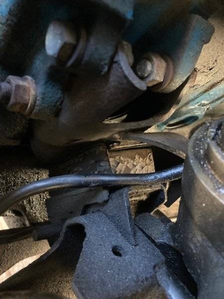

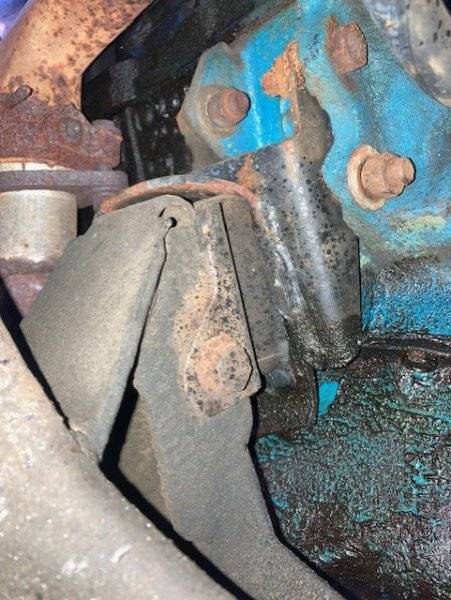

Hey Team, seems my motor mounts are getting tired, too much movement when under torque, so i want to replace them with solids motor mounts.
Can someone tell what i have in there now, its a 67 belvedere ii, someone put a 360 in it, so its been modded
Questions:
Is what you see in the pics an "engine swap" motor mount set?
Are there any differences between the driver\passenger sides, the metal that bolts to the engine or rubber part in between?
Is it ok to use wood and a jack on the oil pan or do i use to bare part towards the rear of the engine? I'm told there is a bare spot.

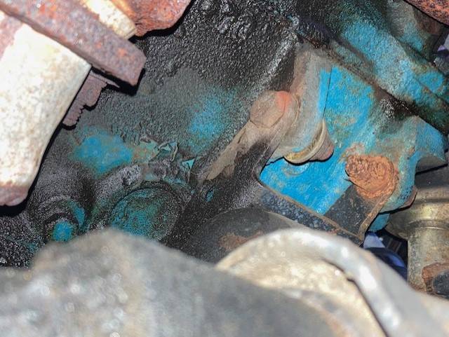

Will solid motor mounts drop right in with the engine swap mount? in the new pic below

The 340/360 engines use different block brackets than the 273/318's do but the 273/318 brackets can be used with spacers or washers....but not sure what's going on with the passenger side but the brackets shouldn't have to come off....just the old biscuits and getting at them will be both from the bottom and the top. Been a long time since doing that job. You will have to lift the engine up some to get things out and back in. And if it were mine, I would use the solid 'replacement' on the driver's side only and stick in a new rubber mount on the passenger side. What I did on my 95 Dakota 20 years ago was to install a chain instead of replacing the broken mount. Yeah, it's just a V6 but I've pulled trailers with it too and the truck has had 1600 lbs in it more than once and the chain works fine and pretty much can't be seen. If the engine isn't producing a ton of power, a 1/8" chain is more than enough.

Thx for the info, why solid mounts on the drivers side only? because that's the side with torque when in drive, and the rubber on the passengers side will provide some anti vibration?

It also will help alleviate the strain on the trans mount that both solid mounts will impart on the trans mount. One mistake some make is to use solid on all 3 points. Never do that unless you like broken transmission cases/tail shafts.

great point, what did you mean when you said you were not sure what's going on, on the passenger side, does something look odd?
Wasn't able to really get a good look. Just might be the design of the mount.

ok, i swapped out the motor mount, confirmed, you can raise the engine with a wood under the oil pan, making sure its a little bigger than the pan, pan doesn't crush.
One has to raise the engine 4 or 5 inches, to get the mount and isolator out as one piece.
Did it in my driveway by myself, the old drivers side isolator was split in half, i replaced it with a solid mount, no more split isolators!
i did have to remove the transmission mount bottom nut, and the throttle linkage, also loosened the exhaust manifold to pipe hardware for safety sake.
its all good now!
