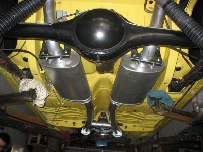

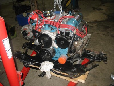

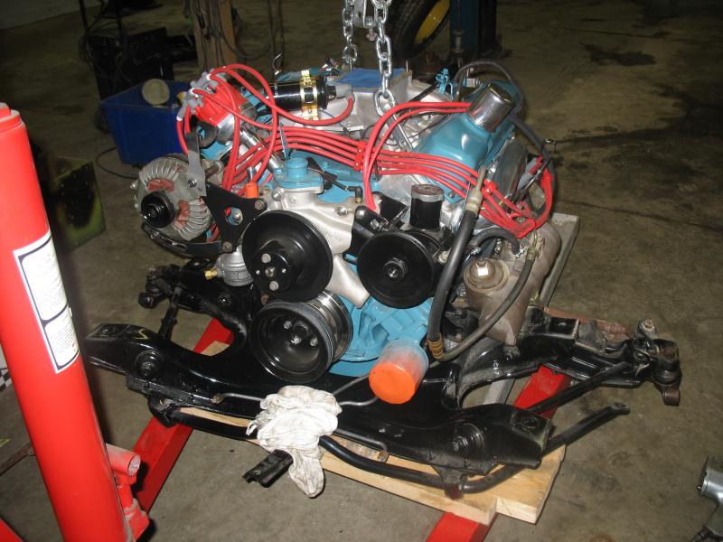

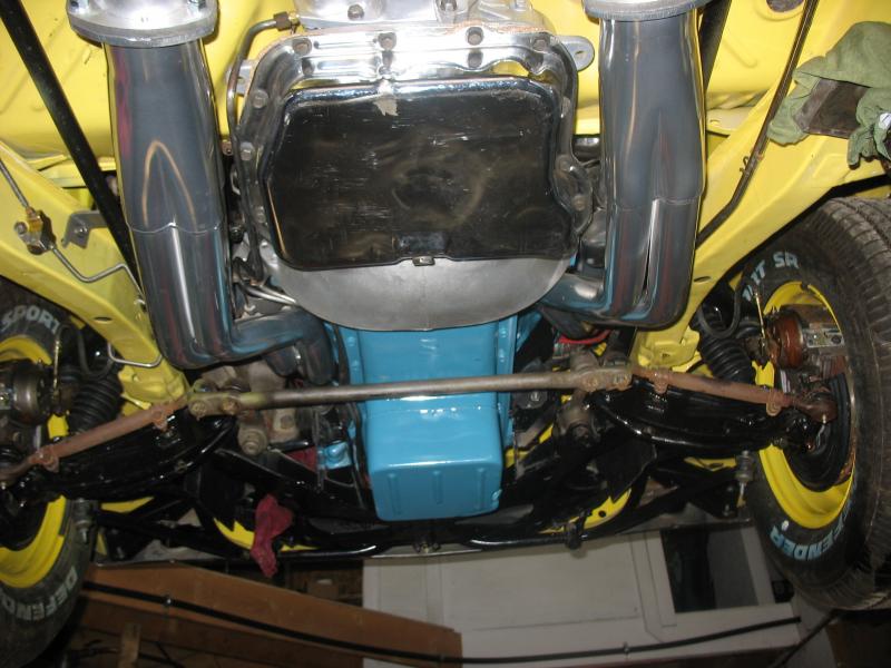

If you have access to a lift , assembling the engine and suspension on the K member is the quickest and easiest way.Had my driveline , suspension and exhaust jnstalled in a day.
as said,if you can use a lift then assembled unit from under side is the way to go.thats how they did it at the factory.
