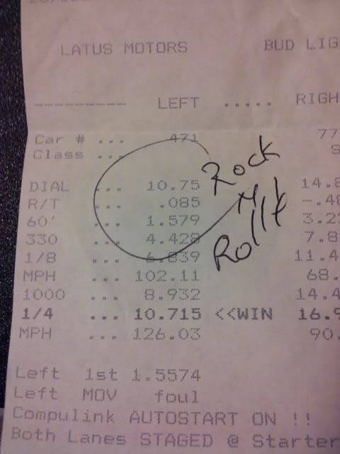

My 67 Dart runs 10.70's off the juice with 4.10's.

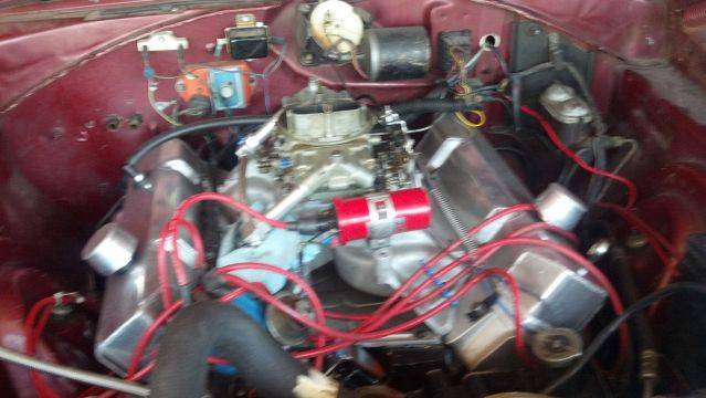

On my charger I'm Taking off the Perf. RPM and putting on a M-1 intake.
That should help me get a better et.

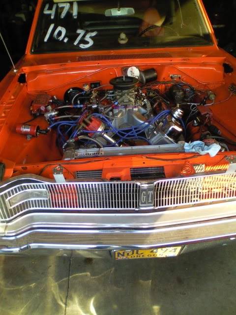

67 Charger ran 11.93-looking for 10's
Pic of Engine with RPM intake.
have a rpm performer intake.

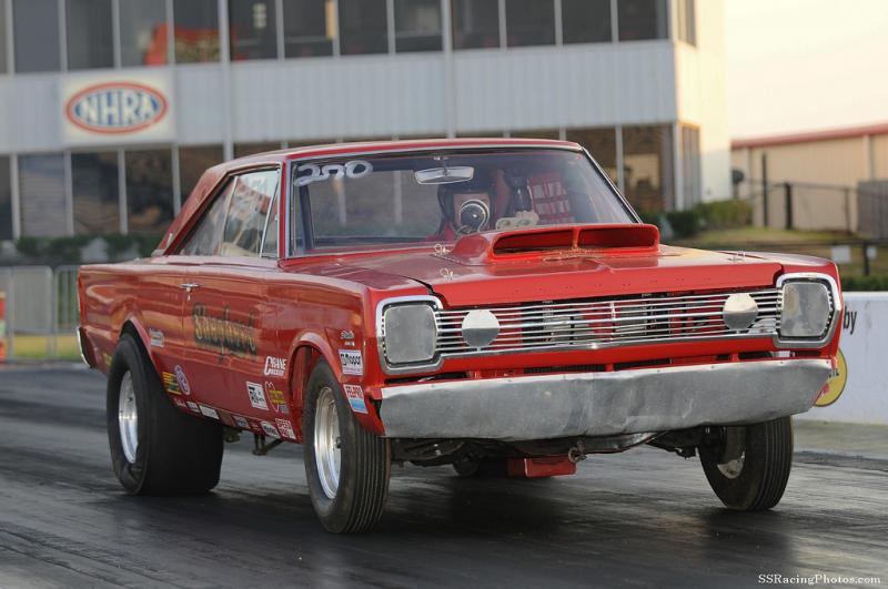

car is strip only.
the weight is due to being nothing but bare essentials to go point a to point b.

from what I have seen on your video's think if you tuned on the chassis would help.how much pinion angel is in it.the rear suspension doesn't look like its working like it could...........Artie
I see you have a 67 deck lid on it. I got my 66 down to 2950 while still driving it with the AC still on it. A lot of people didn't think you could make these cars that light but it's really not that hard. A buddy and I ran a 69 road runner with a .030 440, ported 906 heads, .590 DC cam, an old Torker intake, 850 (your carb is better) 11.5-1, 4 speed, 5.88's, ladders and coil overs. This was back in 1980 when 10.70's was pretty quick for a combo like that. Looks like you have ladders with leafs? which make suspension tuning hard(er) at best. What are your short times?
