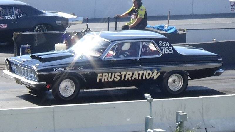

Good information there from one of the best. Thank you. We were racing at Cecil Co. in our '63 Plymouth. The air was good, but not great. I expected to run low, 10.90's at near 124 MPH. Best the car would run was 10.999 @122 MPH. There was a 15 MPH head wind almost all day long. Photo is from Maple Grove the week before.
