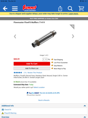

Keeping the Hooker Comp 1-7/8” headers; using 3” mandrel to get Aligned to the torsion bar crossmember reliefs (approx. 12”) then a set of Flowmaster FlowFX bullets (16” long) then short turndowns at 45*.
whole system should weigh about 12 lbs. so I just lost 63 lbs and gained some HP via a better flowing System in the process.

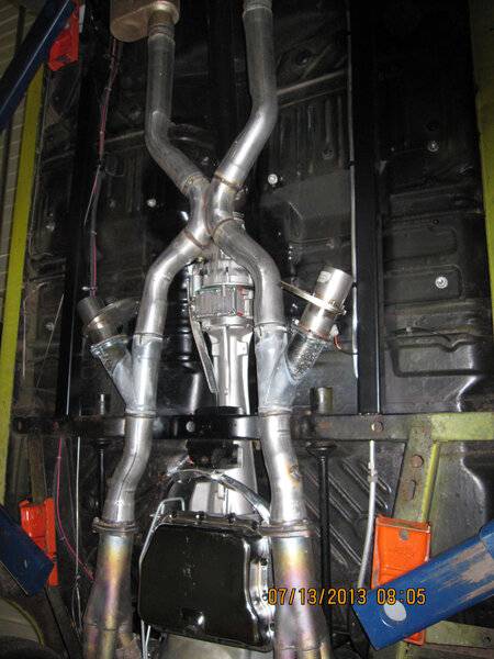

I run Doug's cut outs and picked up 20 HP on the dyno with them open. This is in a 3" system with X-pipe, Flowmaster Delta 44s, dumping ahead of the axle. Doug's uses a guillotine style, self cleaning mechanism. Not the cheapest but mine are bullet proof. I just love to listen to the sound of no/very little throttle cruise-reminds me of drag strip return road music.

I have 3" exhaust, 40 series Flowmasters
a prefab 3" X pipe and :lowdown:Doug's cutouts that are "self cleaning" and get out of the exhaust stream 100% when opened. They had a recall on the serial numbers my 2 electric motors fell w/in, and one had failed. They sent me TWO replacement electric motors, and I still have one as a spare.
1 7/8ths TTi ceramic coated headers.
Performance difference?? Probably NONE, but that's because my exhaust system is EXCEPTIONALLY WELL done.

Now because of the rarity (in the past) of the number of times I took my car to the track, I don't have back to back timeslips to prove that my 3" exhaust allows for the same ET and MPH as when my cutouts are open, and I usually run with them open at the track because I like the sound and it makes it easier to hear my engine working, and eventually I'll get to a local chassis dyno for some data and tuning, but I am confident that there's no significant difference in performance between open and closed exhaust on my car because the full exhaust flows so well.
