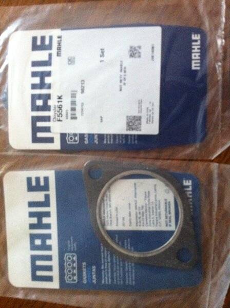

A friend with a restoration shop only uses these Mahle gaskets for the head pipe to manifold connection. The metal ring expands when it heats up, to help to make sure you have a good seal between the two surfaces.
I've struggled with this problem too. The gaskets like Moes has above are typically best. They have to have the steel ring in the center. If not they almost instantly burn through.
