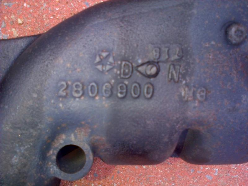

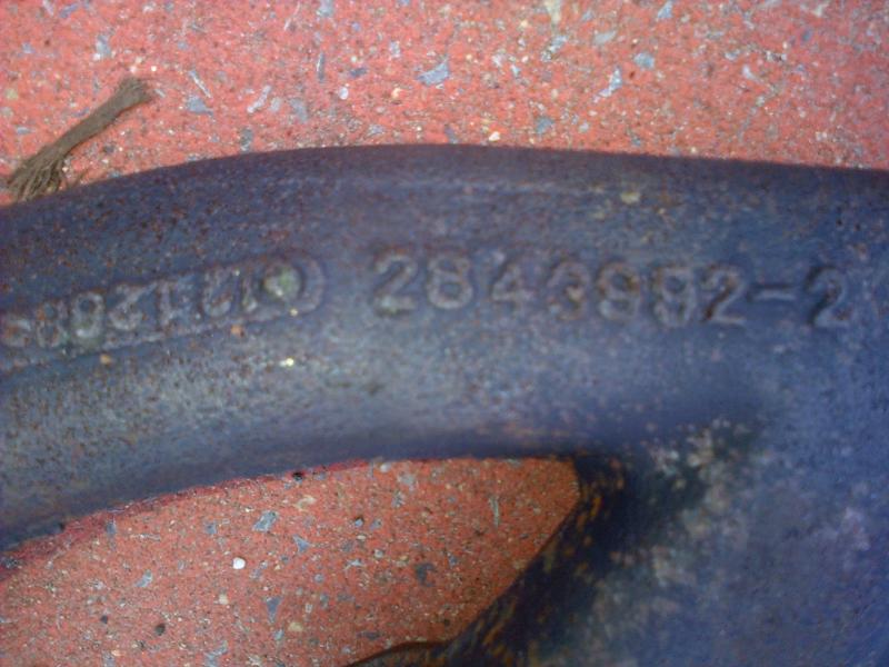

Can anyone help me and let me know if these are correct for 69 383? Thanks IMG-20140612-00533.jpgIMG-20140612-00534.jpg
2806900 - 68-69 383 Magnum right side
2843992 - 68-69 383 Magnum left side, 2nd casting.
(boy, that looks like an upside down 5)
From what I can find.
That's what the 68-69 Road Runners and Super Bees came with.
