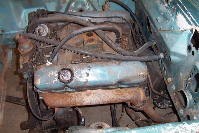

I have a 1964 Dodge Polara 500 with what I think is a 1970 383 4 barrel. It currently has exhaust headers, (old, looks like crap and leaks ) I am looking to see if anyone knows what orginal equipment exhaust manifolds I should use and if anyone knows where I can get them?

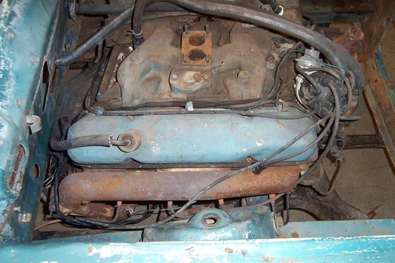

here are the64BB manifolds

According to what I have seen on 64 Dodges and Plymouths, Casting #'s 2203262 (Left) and #2205898 (right) were also used on 383's. These also were used on 64-65 426 street wedge motors. They look almost the same as the pictures Moparmarks posted.
thanks to all for the info. went instead with Headman Ceramic Headers from Summit. looks, sounds great. Look for car on Power Nation, Spike TV last week of July, It looks great under the lights.
