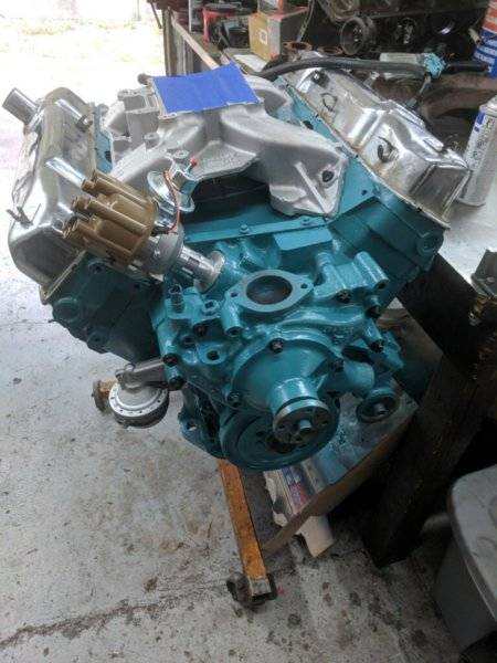

Who has put their original exhaust manifolds (instead of headers) back on after a complete engine rebuild and are you happy?
Reason I'm asking is we are at the final stages of my stroker (505) rebuild and the original exhaust manifolds we took off look fantastic. I'm just questioning the investment of headers when it's never going to see the track. Will any loss of HP (20-40?) without headers be that noticeable when street driven.
Also we are using the original 915 heads that have been machined and ported. Thx.
I had no issues with mine. Leaking headers suck, and wanted to avoid that problem. I couldn't afford high dollar headers as a PFC...
PS.. Be careful with that "Peg Leg" engine stand. That heavy engine can easily tip over, and quite honestly, fully dressed, approaches the 750 lb rating!

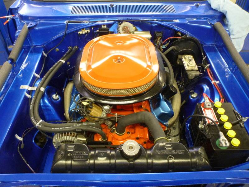

I got the header thing out of me when I was 18.... some 38 years ago ! Don't have the energy for chasing header leaks, etc at this age. Hated it back then as well. Besides, stocks look nicer IMHO ! ..now don't anyone tell me my heater hoses are supposed to cross! :praying:

It's your car and you should do what you feel most comfortable with. This is only what I would do if it was mine. By the way, your engine looks great... love the bluish turqoise correct color!
