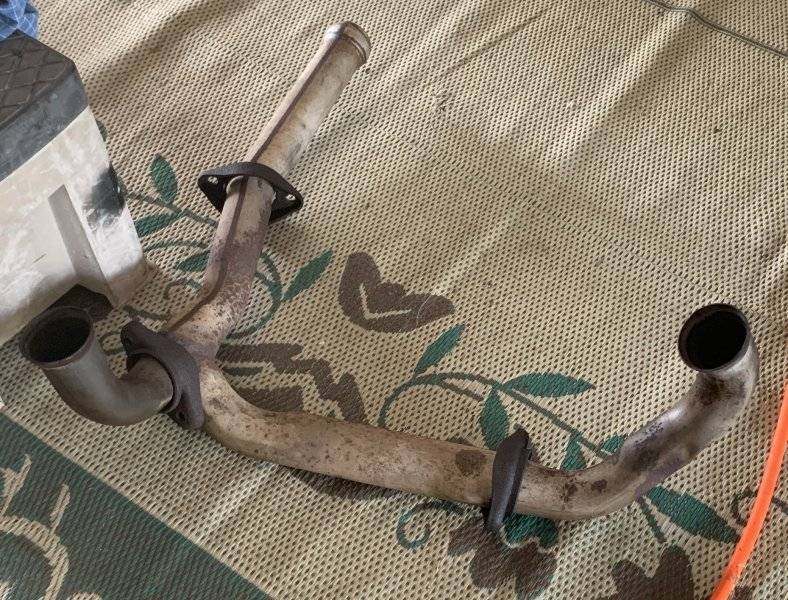

Do you remember if it required any modification? I have a factory 2 1/2" H pipe that was bolted to a 440, and plan on putting it on a 383.
You will have to cut a small slice out of the "H" pipe and reweld it, since a 383 is slightly narrower than a 440 due to its shorter deck.
