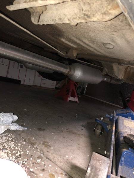

So while I am waiting for some electrical parts I started putting in new rear shocks. After inspection I found Bubba struck again. The exhaust pipes over the rear axle is in contact with the shocks.
So I am looking for inputs as to a easy and decent exhaust sustem. Looking possible from the headers back in a 2.5” system as I am running a 340. I am also contemplating just getting the pipes after my existing mufflers as they seem ok. Looks like others had over the axle issues and I am wondering about the details from your experience.

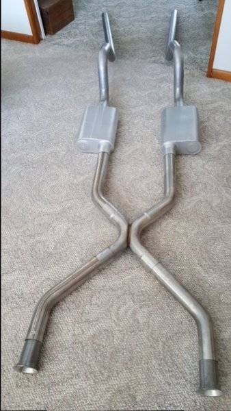

I am anti-$$$$ more like 1/2$ :) I am in past deep on this already.....just looking for good known fitment. This is what I have currently and the issue is after the mufflers. Not thrilled with the mufgler clearance but I can live with that if I can get away with a fix with wrong bends over the axle.

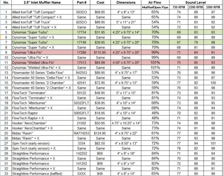

If you are considering new mufflers, check THIS out:
I ran Flowmasters for years. I actually liked their sound. Many guys over 50 do not. I switched to the Dynomax Welded Ultra Flo like you see above highlighted in red. I don't know if there was a power increase directly related to the mufflers because at the same time I installed them, I added a 3" intermediate section with an X pipe. It has less bite, less cackle though.
