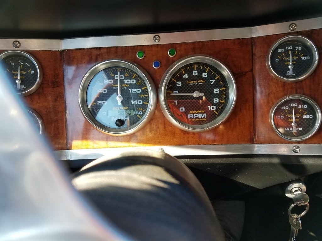

I took this today on the freeway, Viper 6 speed:thumbsup:.
