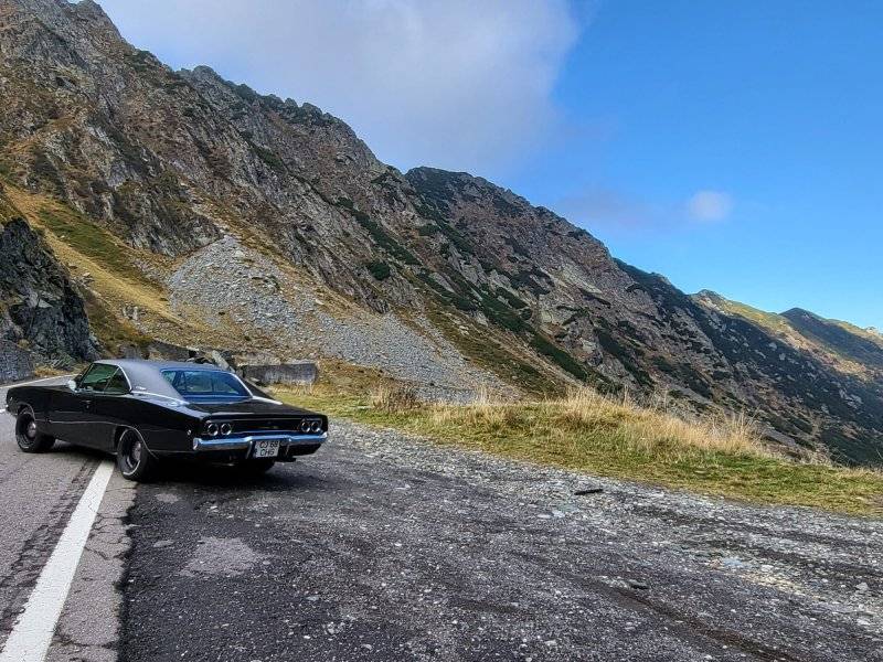

As asked, I will oblige: here's a few pics from when the restoration was almost completed, car had the concours bias ply goodyears. Last pic was on the Transfagarasan, which you may know as the best driving road in the world as proclaimed by Jeremy Clarkson :) I was there 2 weeks ago, it was EPIC!

Nice car!
