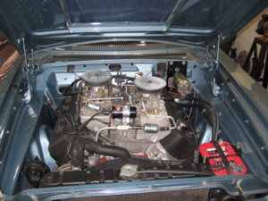

Yep, running Pertronix in the Hemi.Just about as stock looking as you can get.
Sorry, crappy photo.

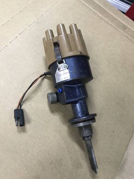

What is wrong with the Mopar Electronic Ignition distributor and then hide the ECU box? Or are we only talking points distributors? I have a tan cap on my Charger distributor and it looks pretty close to stock minus the wires for the electronics.
