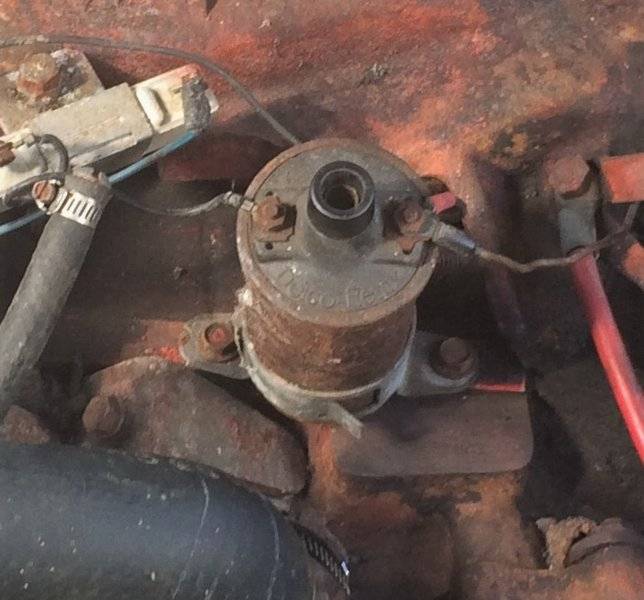

The ignition on my 69 GTX was altered many years ago. I want it return it to stock.I have never seen a coil bracket like this. Any ideas?
Was the Delco Remy your first clue? :bananadance:
It does not look to be stock Mopar but I like it.
Funny how the bolt pattern fits exactly on the pan rail.
Nope.
I’m surprised no one has asked what the deal is with the ballast resistor in the stock coil bracket bolt hole.
The guy who owned it really screwed the wiring. one ballast on the firewall, one as shown...and an aftermarket distributor! Its all getting ripped out.
