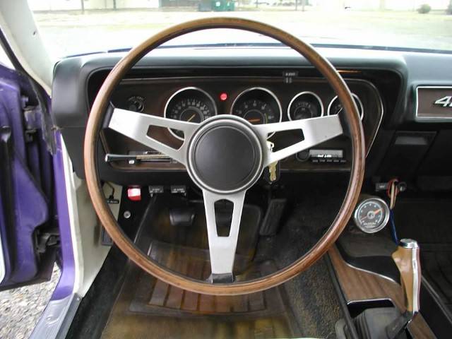

When i had my 71 Hemi GTX car, i purchased it with the SUN Tach, on the console.
Sometime early in my ownership, i decided to install a factory tach, in the instrument cluster.
Surprisingly, they were always close to one another, in their readings.
