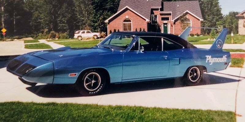

I wouldn't discount 14" wheels. Here's my first Bird with 14" wheels and F70 RWL Goodyears:

Just to further add my two cents again, referring to the picture of my B5 Superbird, it had NOS 14 x 5.5 Road Wheels. All Superbirds came with front (power) disc brakes. The rears were drums.
I understand your reasoning for larger rims and tires. I just thought I'd toss this in.
