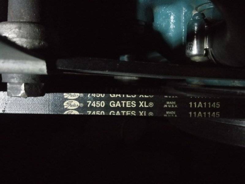

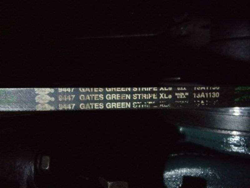

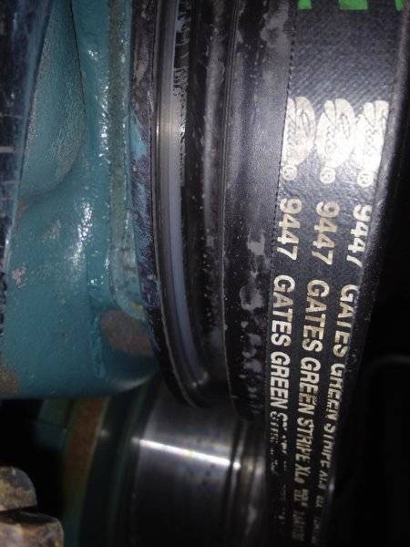

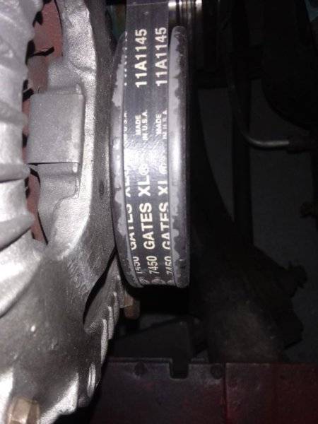

Thanks guys. Here's pic's of my belts.
Fan / Alt = 7450 Gates XL 11A1145. In Red Letters are 226ET 32,33,34
Fan / PS = 9447 Gates Green Strip XL 13A1130 In Red letters looks to say 445ET but hard to read as the numbers are almost gone.
