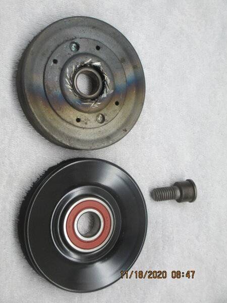

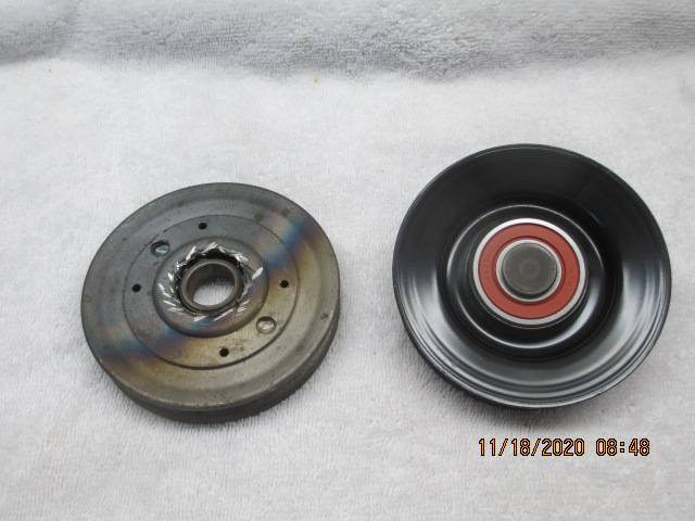

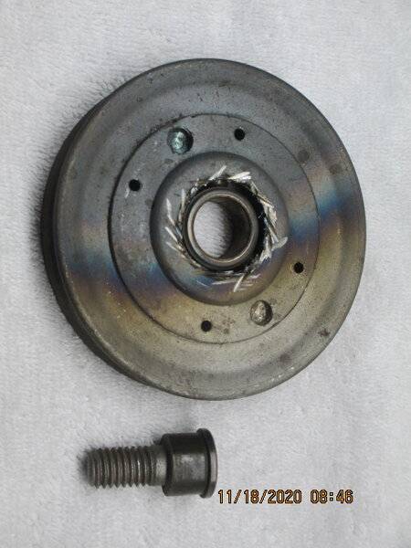

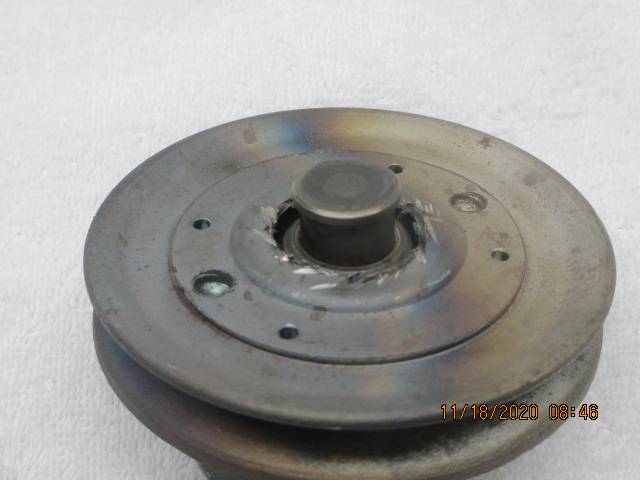

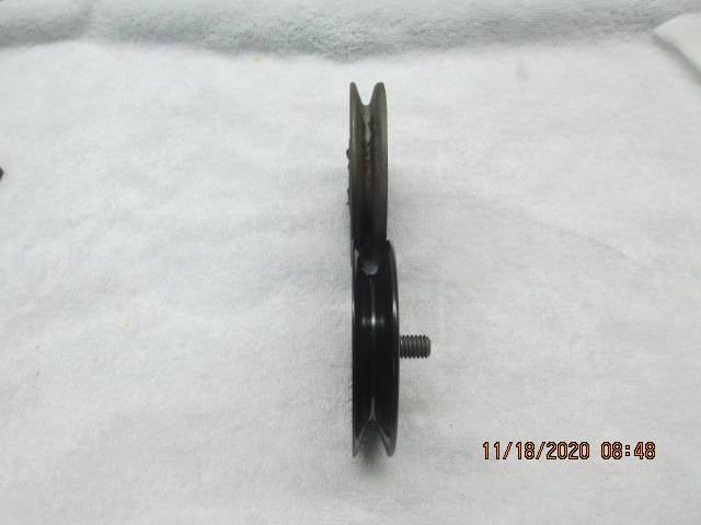

I have found a cheaper alternative to the reproduction fan idler pulley. Any of us that have the AC equipped cars usually have one with a rough bearing. I was going through a Goodyear tensioner and pulley catalog recently and found a very good replacement. Although it does not have the bearing cover on the outside. I have looked quite extensively for this shoulder bolt that is used. I could not find one. I had several idler brackets with bad bearings. I tried to get the cap off, but it is fused on with some copper colored substance. I could not get one off without ruining the cap. So here goes. You have to cut the cap off, I used a die grinder with a small wheel. Then the bolt comes right out. The new pulley is offset just a little to one side, so you have to match it to your pulley. Continental bought Goodyears Industrial Products. So there is no more Goodyear belts or hose-it is now Continental. The part number for the Continental pulley is 49034, they are available on Rockauto for $12.00 I believe. Sorry, my pictures did not end up in order. I hope this is of use to anybody. If you have an extra pulley, get the shoulder bolt out, get a new pulley, put it in the box, just change the pulley when you need to without having coolant run all over.
