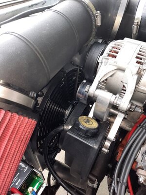

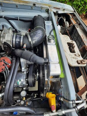

I got the Cold case fans to fit, they just didn't flow enough air. So I had a custom shroud made with 2 12 SPAL fans (real, not SPAL like) and it works so much better.
Yes, a tight fit!
