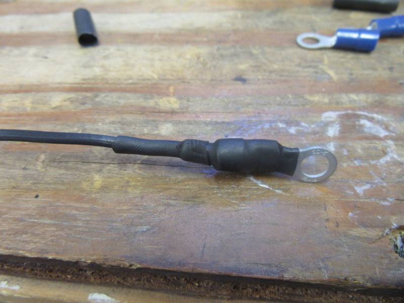

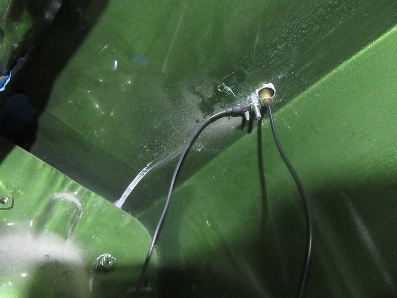

I put longer studs on the housings. Then I ground the paint off the underside of the fender, used captive lock-washer nuts to dig into the metal. Next was a ground-wire to be screwed into the core support, with a second lock-nut to the stud. When finished, I'll hit the whole deal with a squirt of under-coat.
Nothing wrong with a few extra grounds. I like it!
