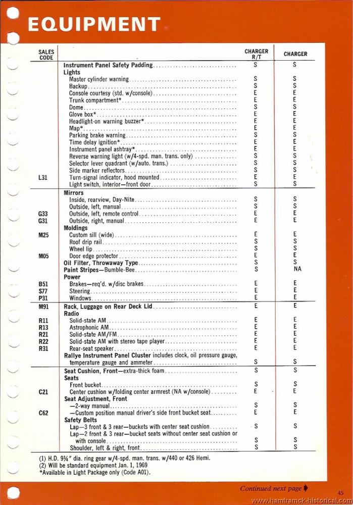

I think there would be another code for them, probably L31.
Here's a factory code sheet that shows the L31 code for your Charger.

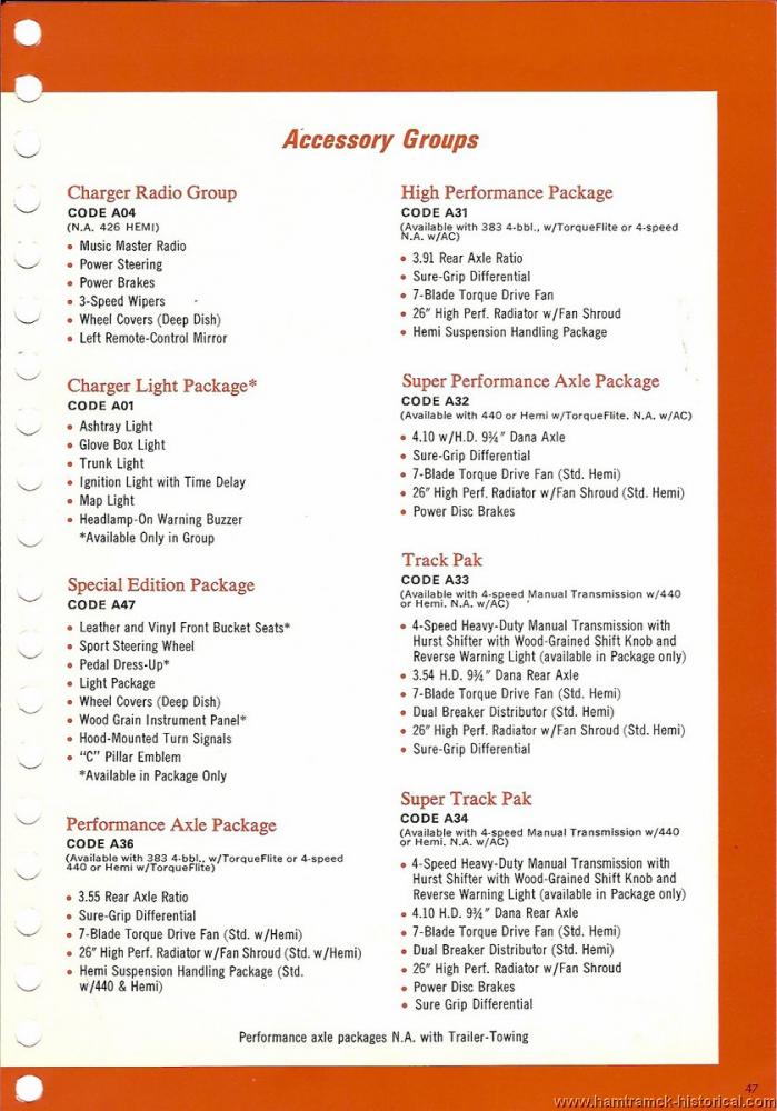

Here's another data sheet for the '69 Charger showing the A01 light group. It does NOT show the fender mounted turn signals as part of that group.
Those pages are more informative than the white Govier books that I have. I think you are right and it would have been a seperate code. If anyone knows of a set of blank off plates for sale please pass the info. to me. I have a nice set for a 70 Charger if anybody needs them.
L31 is the code for fender and or hood mounted turn signals. If your car has the original forward light harness you would also have the extra wiring/connectors for those lights......
