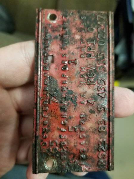

Can the Q under U be a factory mistake.
I don't remember what color Q is for the upper door frame, but there is nothing under the S so it's not coded for stripes.

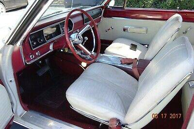

67 GTX stripes are not under S. This car doesn’t have stripes. It’s hard to explain where it goes, I’ll try to post a photo of it. Instead of PP1 it would say something about else.
Q is dark red upper door frame paint and that is no mistake with the P6V interior code, which is red and white interior. A great look IMO
The picture you posted is a car that is for sale on Ebay right now for 29,500 I believe. I like that red and white interior.
