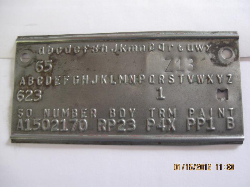

    Fender tag
    Here is a picture of the fender tag.

    a/6 = console
    b/5 = bucket seats
    AB/62 = 383-4BBL
    C/3 = four speed
    R/1 = AM radio
    A15 = scheduled production date = October 15 1965
    02170 = remainder of the Sales Order number.
    RP23= Satellite two door hard top
    P4X = interior trim code = Premium level interior; black vinyl bucket seats
    PP1 = exterior paint color = car top and bottom painted bright red
    T/B = inner uppder door frame painted black to match interior.
    Nice car!
    The Z13 and punch through the tag are related to production and inspection.

    Thanks everyone for all the info. You guys are great. I love this site. Maybe I can help someone sometime. THANKS, MV383

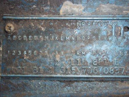

    Any idea what options my car was born with seeing as I have nothing in the lettered rows?
    I know the build date, interior colors, axle ratio, engine, and tire size but what about radio, brakes, etc?
    WL21...yeah its a coronet 2 door post

    No codes mean it is a no option car.

    No radio.
    Probably had brakes. ;)
    Damn...did a priest order that car?

    No just some old folks who were younger back then. Spent the majority of its life driven by a little old lady. Though I'd love to meet her...little ol lady drove 96k with 3 on the tree behind a 273 and manual brakes....though she did hit a few things.
    I am sure it had drum brakes and of course manual but I know somebody hacked in an AM/FM radio from a late 60's to 70's car at some point. i was just curious to see if it actually came with one. Nice to know that it had NO options...:eusa_boohoo:
