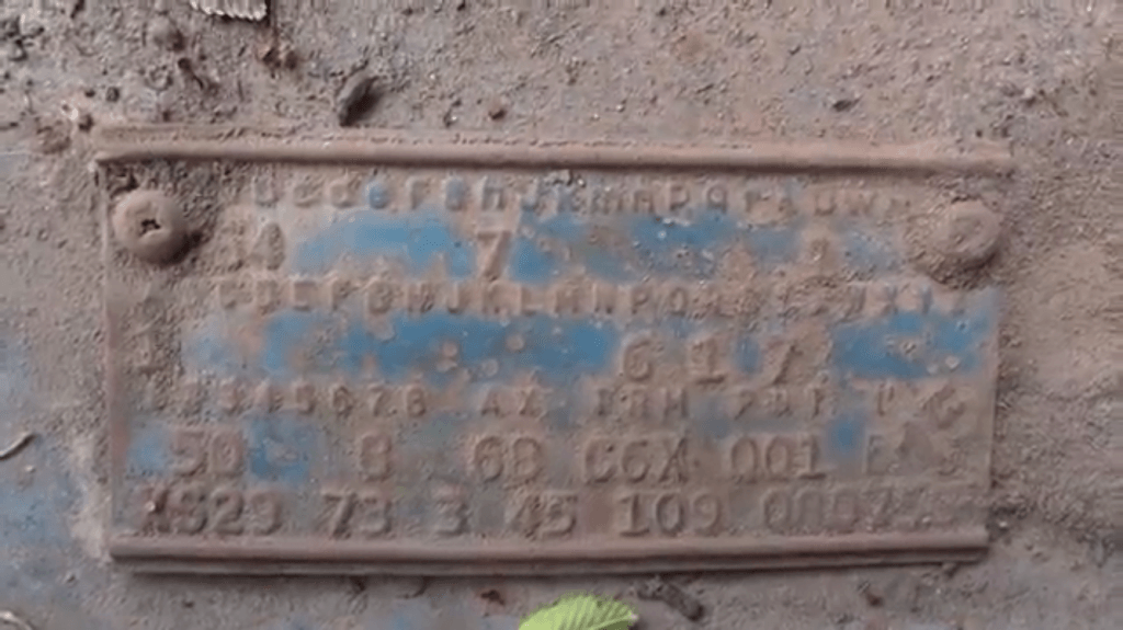

could someone help decode this fender tag?
1968 charger . 73 = Hemi / 3 = 4 speed / QQ1 Brite blue. Under the T is tac. I think im right on this, just off the top of my head..
Dont tell me you found this car and is for sale cheap. Tag looks like the car has been sitting a long time..
Car came with buckets, console, Fender turn signals, Rear speaker, AM-FM, drip rail, belt moulding,wheel lip moulding.
3.54 dana..
So whats the story behind you wanting to decode this tag.. Come on whats up...
My buddy was looking at a cuda and this is the fender tag! I don't know what the story is yet! I kept thinking I was deciding it wrong but I guess not lol! I will let you guys know the details as soon as I find out! Thanks for the help!
The tag is all he has shared with me so far! Hope to see pics tomorrow! He says its a small block cuda so we will see!!
That tag is on a Cuda? Looks like it's screwed into dirt pile.
