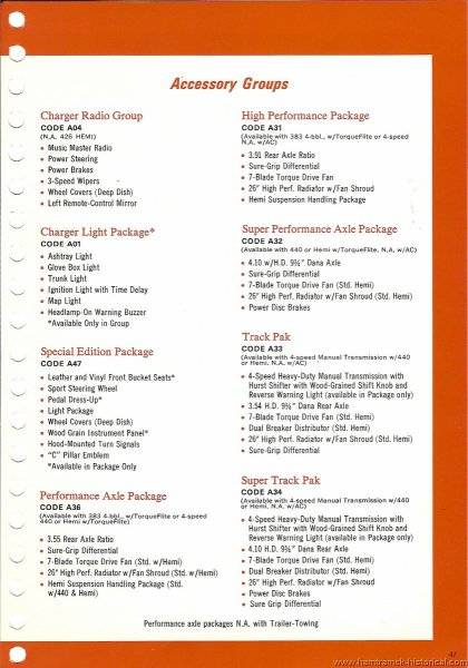

The next code is the beginning of the listing of all the major option codes which will be listed in alphabetical order working left to right on this line and then moving up to the next line, again left to right until you see the code END indicating the end of the option codes. Not all option codes are found on the fender tag, the full listing is found on the broadcast sheet. The following lists the option codes that are known (with proof) to be listed on fender tags if applicable:
A01 = Light Package (standard with Special Edition) Lights (Ash Tray, Glove Box, Map, Trunk, Hood Mounted Turn Signals, Ignition With Time Delay and Head Lamp-On Reminder Buzzer
A04 = Radio Group Package - Music Master Radio, Power Steering, Power Brakes, 3 Speed Wipers (standard with 383 4bbl, 440 and Hemi engines), Deep Dish Wheel Covers (standard with Special Edition) and Left Side Remote Mirror
A31 = High Performance Axle Package 3.91:1 Ratio 8.75 Axle
A32 = Super Perf Axle Package 4.10:1 Ratio 9.75 Dana 60 Axle Auto Transmission
A33 = Track Pak Package 3.54:1 Ratio 9.75 Dana 60 Axle 4 Speed
A34 = Super Track Pak Package 4.10:1 Ratio 9.75 Dana 60 Axle 4 Speed
A35 = Trailer Towing Package
A36 = Performance Axle Package 3.55:1 Ratio 8.75 Axle Auto Transmission
A47 = Special Edition Package - Only Available on XP29 (500 model) and XS29 (R/T model) - Leather and Vinyl Front Bucket Seats, Wood-Grain Sports Type Steering Wheel, Pedal Dress Up, Light Group, Deep Dish Wheel Covers, Wood Grain Instrument Panel (standard on R/T)
A73 = Charger Special Value Package

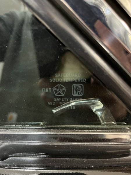

Presuming you have A/C then? I believe tinted would be the default with A/C. What year ('69 by your avatar?) and assembly plant? (they're not consistent throughout)
No AC, it’s a factory black car built in St Louis. Just speculating, maybe black cars got tinted windows. I don’t know…

Only certain options were stamped on the tag, engine/trans/paint/interior/ AC/ lights/ tach/ Special Edition/ power windows/ and others.
If you had H51 AC it would normally have tinted glass,
