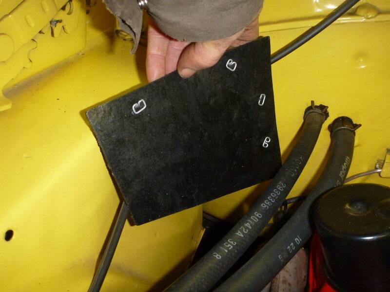

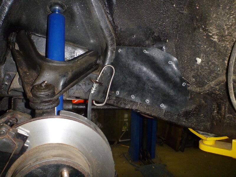

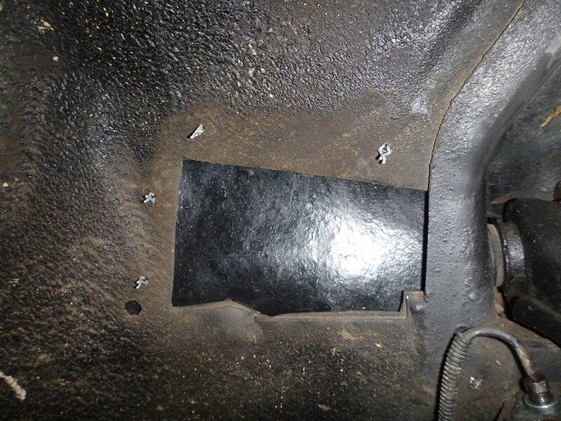

The attached picture is for a 1970 Superbird and I'm trying to figure out what fills this opening? I'm thinking it's one of the rubberized flaps used inside the fender wells with
the stainless steel spring clips but would like to be sure. Any help would be appreciated.
Thank you,
WayneView attachment 963818
You'll want the 1970 B body frame rail splash shield. https://www.restorationspecialties.com/Splash-Shield-Seals-Inner-Fender-Seals_c_294.html

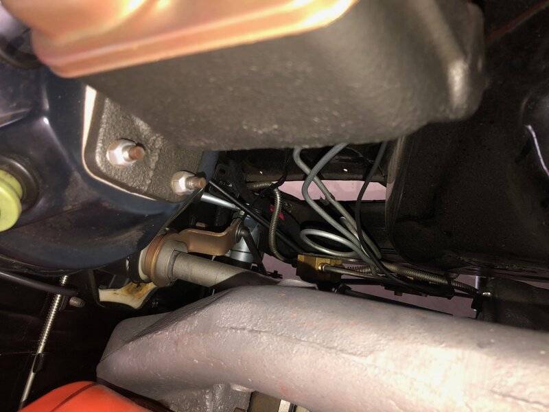

Mine had a bad lid gasket, so the paint is long gone.. but AFAIK it's supposed to be all Black as Jerry points out. Where's that @Mopar John guy?? LOL Mine has the correct lid... hard to read after 50 years of beating though..
