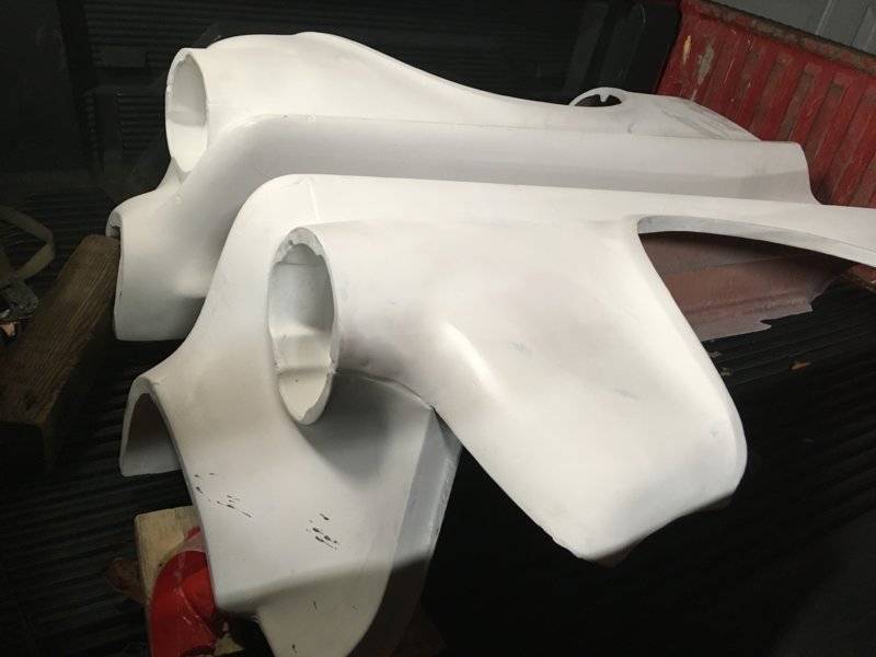

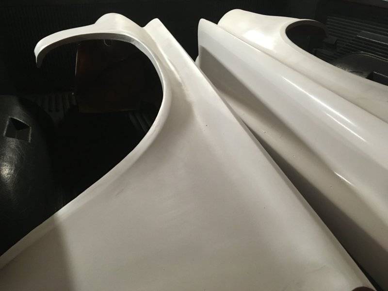

My winter project arrived from Sled City. Well I actually drove down and picked them up. Fiberglass front fenders for my 62 Dodge Dart. They are very well constructed. Nice and sturdy.
Larry at SCF is a great guy to deal with. He has some great stories too!
I will have my old fenders for sale after the swap. They are very nice. No dents.
Just wondering,what kind of weight savings with the fiberglass?.

So I got some weights.
Steel fenders-31lbs
Glass fender-21. The big thing is the weight reduction is at the very front.

10lbs. of weight reduction for $1000.00 is crazy. The trunk lid is heavy. That's the best bang for your buck imo.

The weight number I put up were the actual weight of the parts, not the weight savings (except the front fenders)
You have remember these cars are long so anything weight off the very front of the car is huge.
