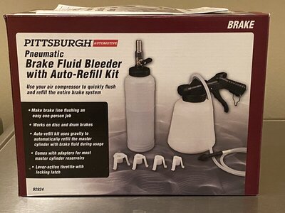

I have a pneumatic bleeder kit, that hooks up to an air compressor, that I got from harbor freight (months ago). My compressor is a 6 gallon pancake with max pressure 150 psi. Bleeder kit says to use with pressure range of 90 to 120 psi.
Don’t know how well the bleeder kit will work with a 6 gallon tank pressurized to only 120 psi.. I know I’ll have to bleed till pressure drops to 90, then run compressor back up to 120, and repeat. Don’t think I’ll be able to use the filler bottle, as it’s designed to mount on a modern reservoir that has a round filler hole with screw on cap.

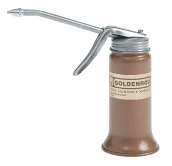

For a dry system I use an oil can, throughly cleaned, take it apart & get any oil out... Then run a little brake fluid through it to be safe... Then fill it with brake fluid....
With the lid sitting on the M/C, I start at the right rear, use a rubber hose to attach the oil can to the bleeder (open the bleeder a turn) pump maybe 15 squirts of fluid, the close the bleeder... Move to the other side, this time maybe 30-35 squirts then check to see if your getting fluid to the M/C, I like to push enough fluid through the bleeders to get at least 1/2" of fluid in the bottom of the M/C.. Remember to put the cover back on..
Next go to the RF & repeat, then go to the LF... After pushing fluid through the whole system you'll need to pump the pedal a few times to seat the calipers since they were probably fully retracted...

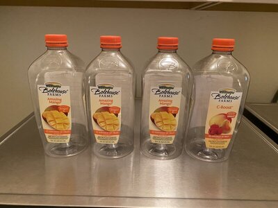

There is the gravity fill/bleed method also.. I have saved four empty plastic bottles over the months. I could get some clear hose to run from each bleed screw into each bottle.
Could try the gravity method first, then the vacuum/compressor, if the gravity alone doesn’t work.. maybe gravity to fill, and vacuum for final air purge..

You don't need to bench bleed if you use the vacuum bleeder in your picture.
Just suck it through the bleed nipples.
I always do mine that way - very little mess and you can do it by yourself.
