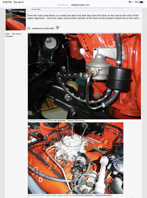

I’ve seen this filter on a lot of cars/pics. What brand is it?
Going on a 440 with return line. Thanks!
It's a fuel vapor separator. Available as a reproduction part. Brand unknown.
I bought one from Rock Auto, a few months ago, as a spare.
