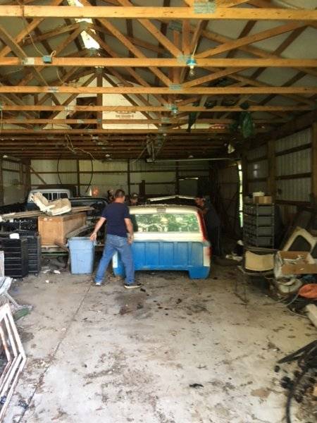

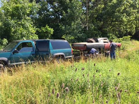

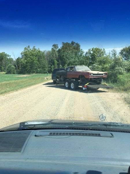

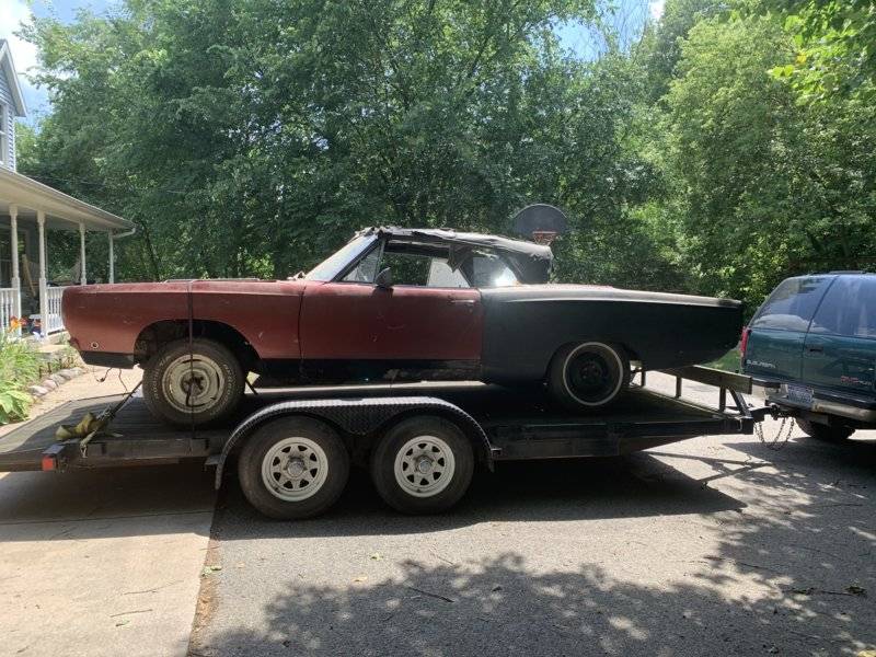

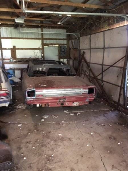

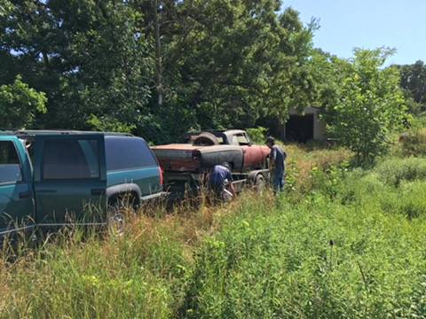

The field that the barn was located in finally dried out enough So we decided to go in on a rescue mission. Lol.

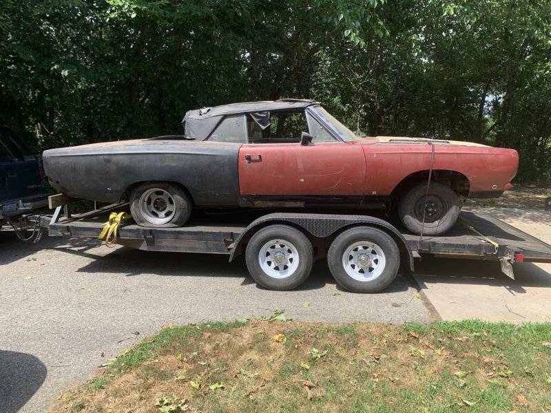

Aired up a couple tires, replaced a couple others and the car almost jumped onto my trailer. Lol. Easiest load up ever.

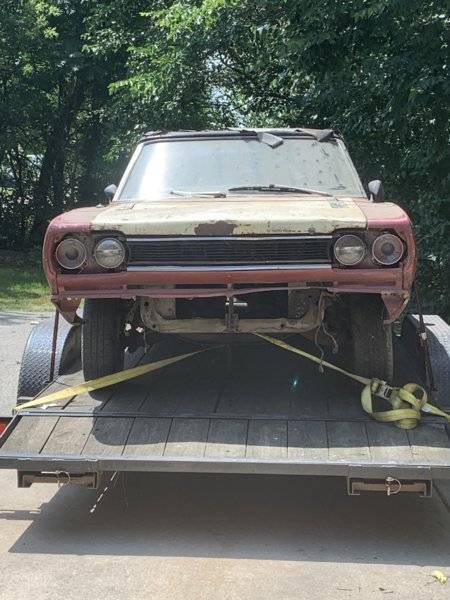

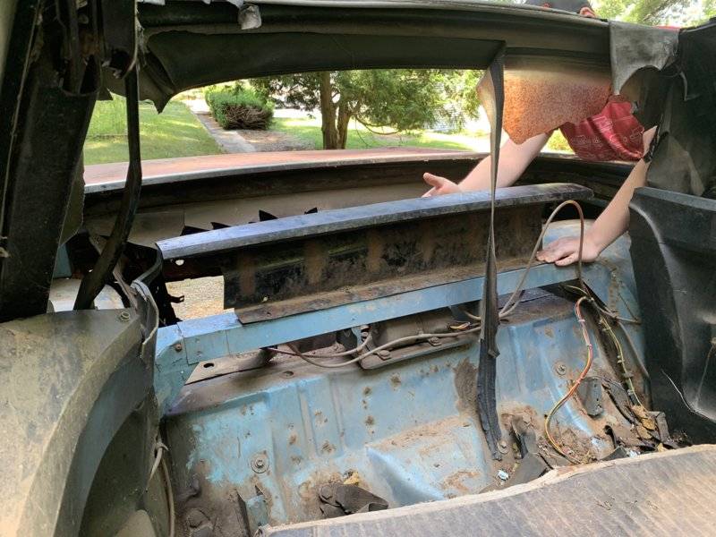

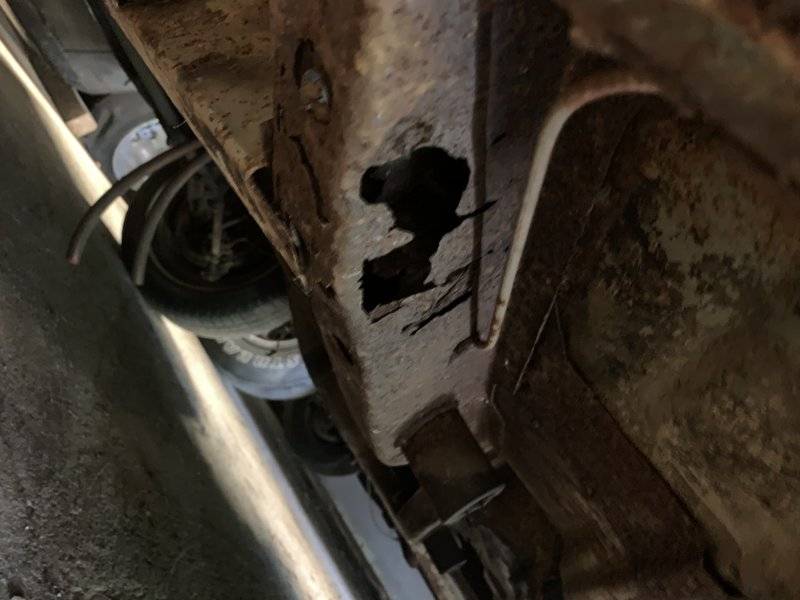

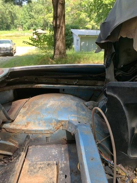

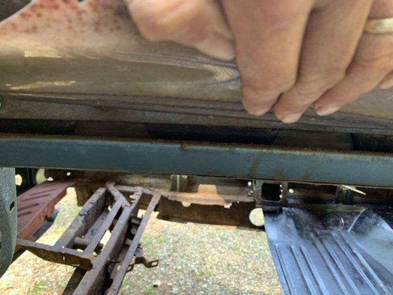

The floors are more patched up than I remembered, and it needs a full floor pan.
And the front of the rear frame rail also needs to be replaced also.
That took the wind out of my sails a bit. But nothing we can’t tackle.

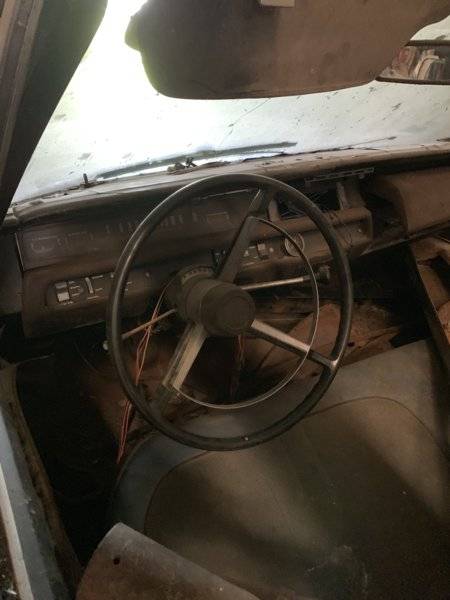

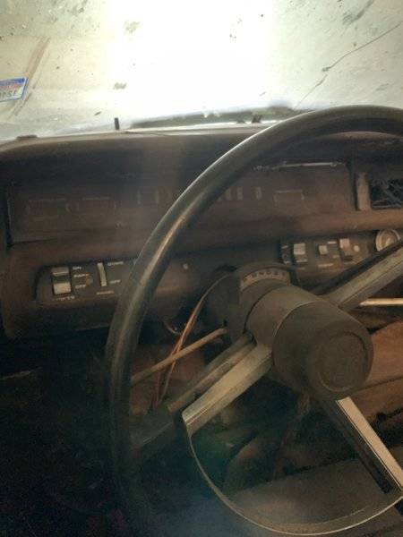

The dash is there but rough and missing a lot of trim pieces.

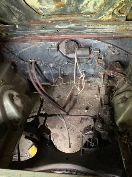

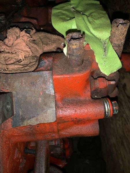

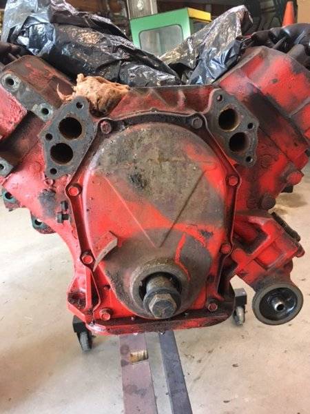

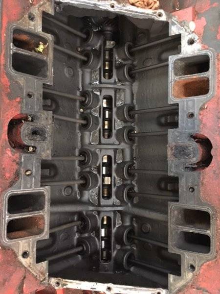

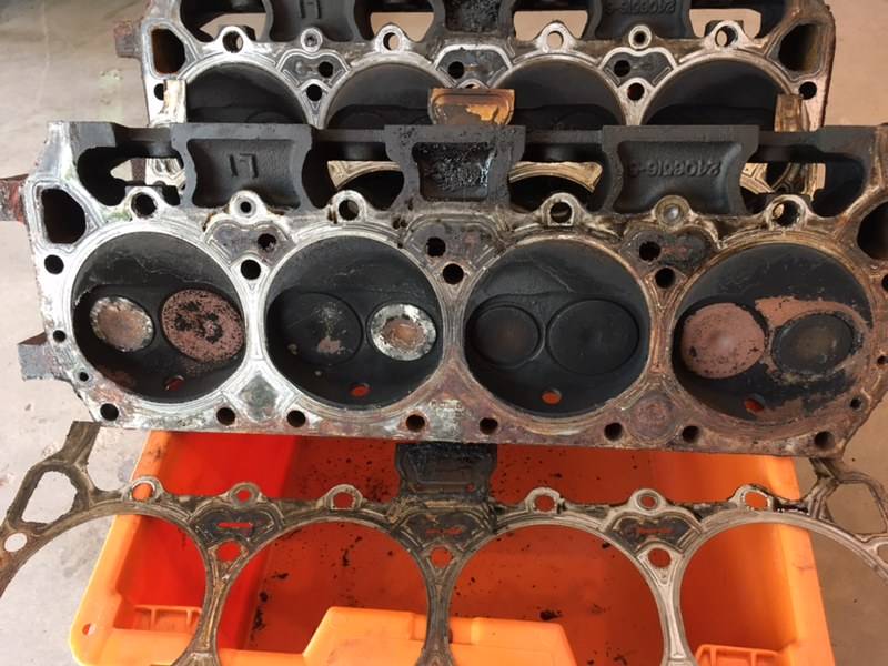

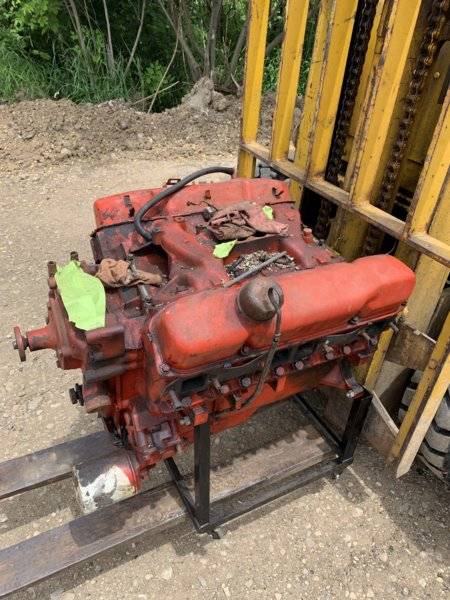

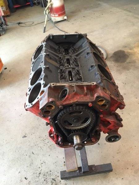

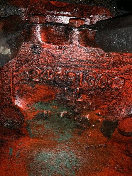

And it came with a 1967 383 that was all original. When we tore it down it was in beautiful shape. Just a hone, rings and bearings and it should be good to go.
No transmission though. But 727s are all over.

It already had new quarters, outer wheel houses, and rust free front sub frame from the torsion bars forward installed.
They also installed new trunk pans and drivers side partial rear frame rail.
But unfortunately the front of the rear rails are junk so we’re putting new full rear rails and interior floor in it.

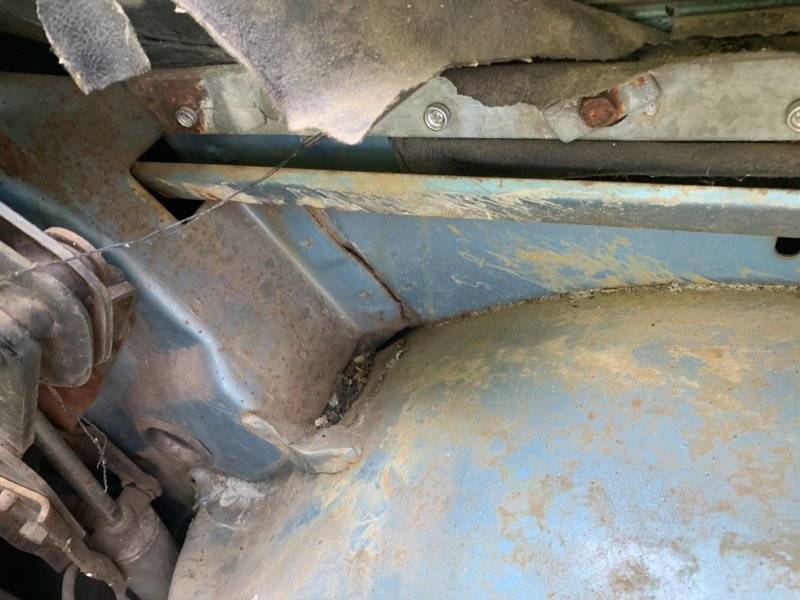

The mistake I made when doing the metal work on my car was not looking at the metal were those long screws hold the convertible top material in the trunk well. Some were stripped and the guy doing the top had to rig up other screws. Make sure you pay attention to that area as well as the gutter edge that drains into the quarter panel. We blocked those dams off at the ends and put drains into the wheel wells.

Where is that piece that the top screws to?
There are "retaining braces" that the top material staples too... center/left/right. These retaining braces bolt into the body & sometimes those threads in the body can strip out. Some of the holes you can put a longer bolt in & a nut in back. Other holes must be welded & re-tapped. I have a "few" extra '68 convertible pieces like the top of the passenger quarter panels, some of those "drain troughs" and trim along the top of the body where it meets the top if you want to pm me. Those "drain troughs" run all along the body where the top meets it. They collect the water that leaks past the top & dump it near the rear wheel wells & it drains out through holes at the bottom of the quarters.

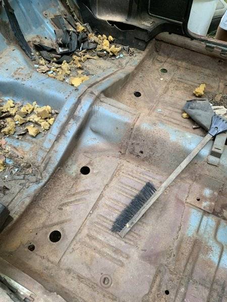

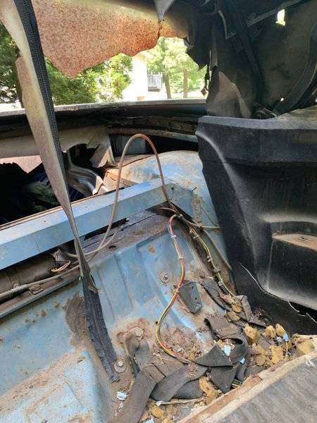

We went over and cleaned out the interior today.
The floors are a patchwork quilt. Lol. But we were already planing on doing a full floor pan.
And the torsion bar cross member is toast, so we added that to the shopping list.
Classic to current sells a nice looking one that’s priced pretty well.
Good news. The drain troughs are in excellent shape.
Bad news. The plastic side panels are broken beyond repair. They are missing the entire piece that wraps around the back where it meets up with the steel back panel.
So we’re still evaluating. But currently considering a way to mount and brace the car on a rotisserie and do the frame and floor work on that.
