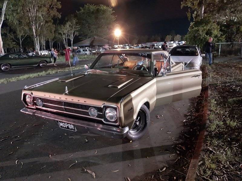

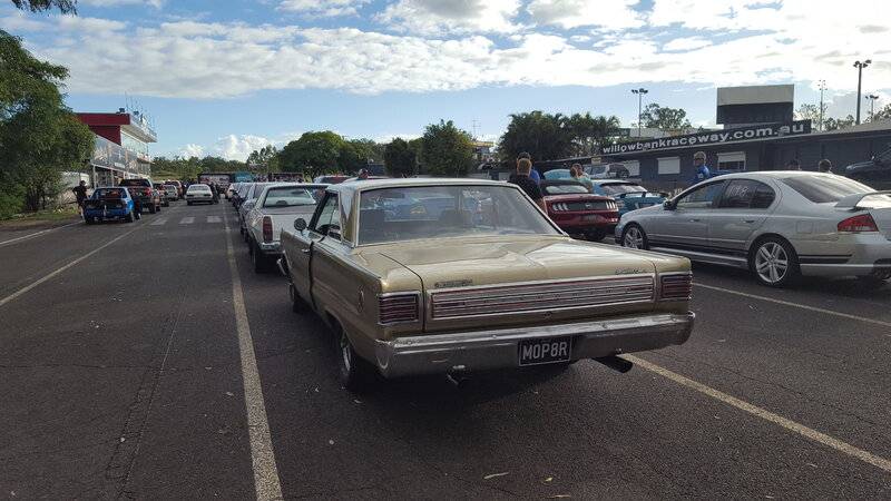

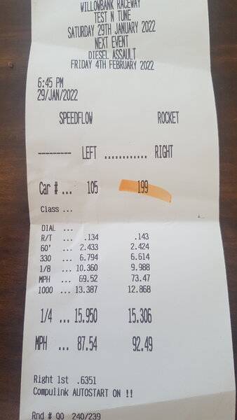

Went to the drags last night after 2 miss starts (one weather related, one Covid related).
Did 3 runs, nothing spectacular but solid for a 318 poly, 3.23 rear, factory exhaust manifolds, 3,750 lbs incl driver. Each run was within a tenth and 1 mph. Best was 15.3 @ 93 mph.
I was shifting manually at 5,500 rpm, and my son reckoned the car was one of the best sounding (and slowest!).
A set of TTI headers would probably get me into the 14's.
Had a lot of fun regardless.

Thats about a second faster than I would have guessed by the description. Nice job.
Edit: your second half of the track is better than your first half. Typical of cars with stock gearing and converter.

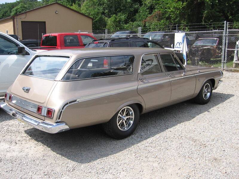

I may have shared this with you before, My buddy's 390 stroked Poly.
This thing has un-believe-able torque and power in his 64 Polara Stationwagon.

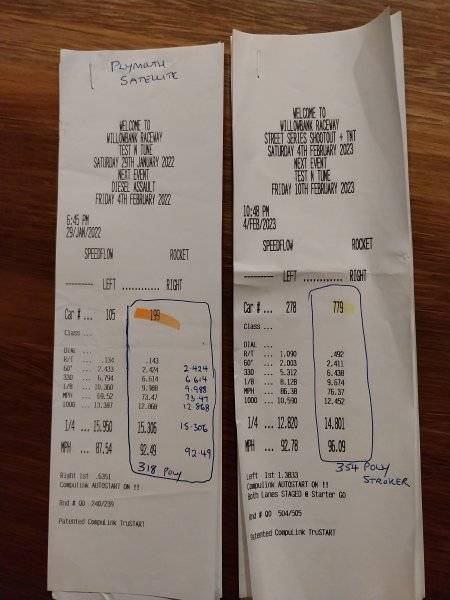

Well I got back to the track on the weekend with the new 354 cube poly stroker (3.58" crank).
Completely unchanged set up from before - same cam, same carb (600 Holley), same 3.23 rear, factory convertor, full street trim, same super-restrictive factory exhaust manifolds, nothing changed except engine rebuilt with new rotating assembly, and bigger valves (1.94" / 1.60").
On the street the car feels much more torquey than before so I was happy anyway, but interested to see if it made any difference at the track.
Before rebuild 15.3 @ 92.5 mph
After rebuild 14.8 @ 96 mph.
My technique is basically a fast street start, load the convertor slightly and then floor it. I tried shifting at 5,000 and 5,200 rpm but it didn't make much difference. 5 runs all very consistent.
Headers next - I really think they will make a difference with the bigger capacity - the difference in the transition between the manifold downpipe and the 2.5" exhaust is ridiculous - the manifolds are like pea shooters.

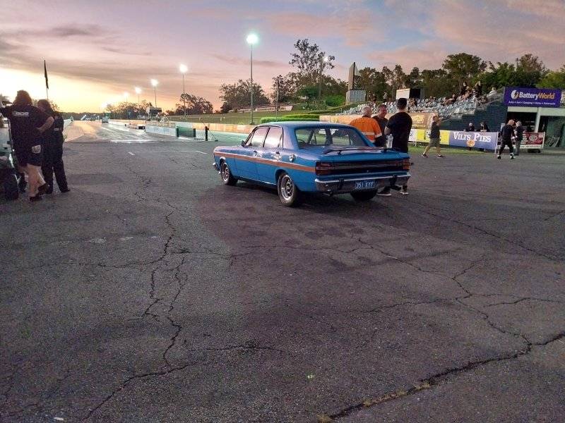

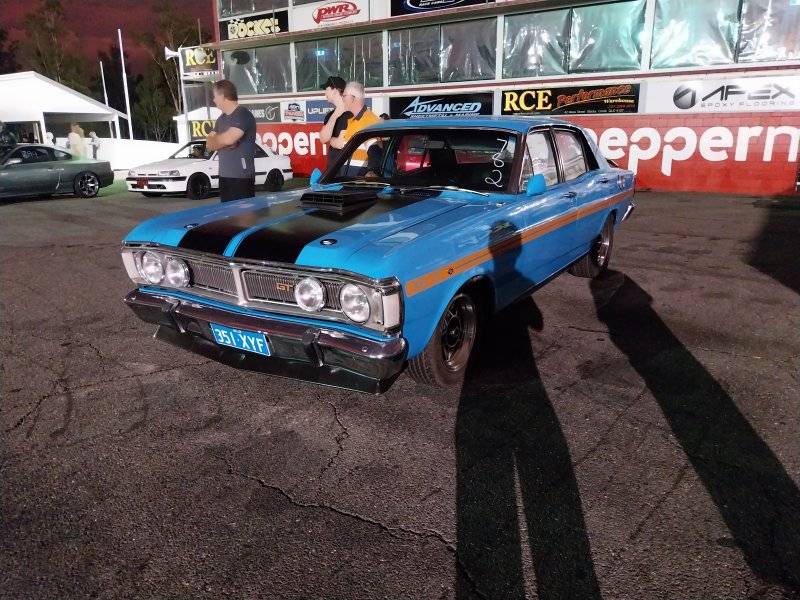

Some nice cars there, a couple of nice Chevelles (forgive me but I like them), a nice Ford Falcon XY GT.
Didn't get home until after midnight, not easy sneaking in with glasspacks...
