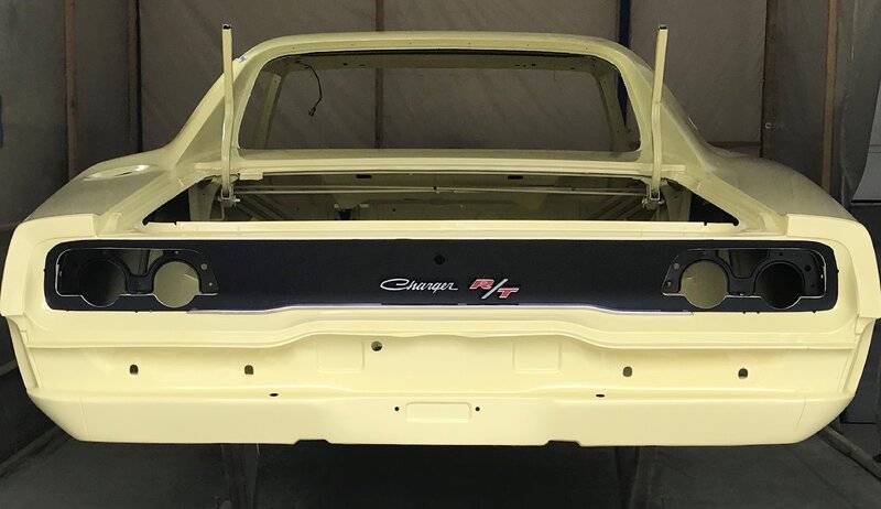

Finally outta paint prison

Looks good. How long were you in for?
Thanks brother.

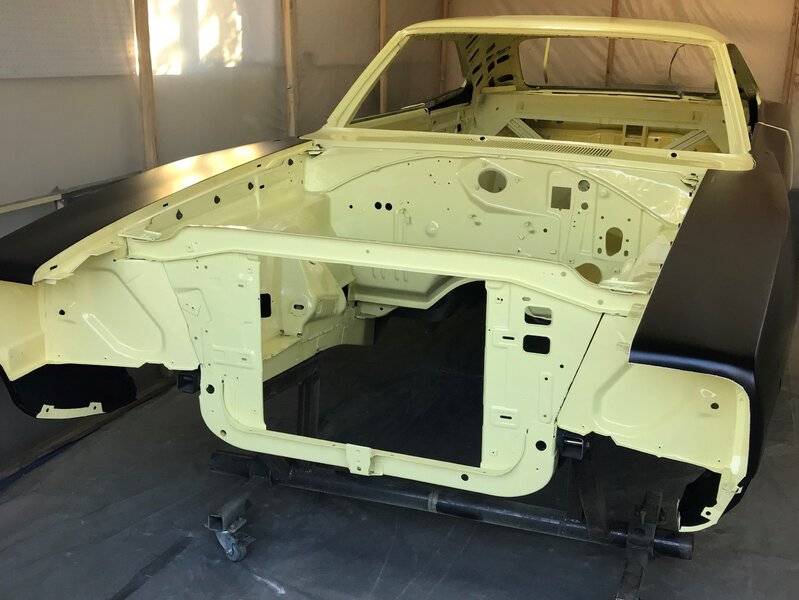

I pulled the trigger on the restoration in 2007. The shop I used was one of nightmares, long story short I just just said #uck it and painted it myself. I'm into the paint job less my hours for under 4 grand including 4 gallons of base and 4 gallons of clear and all the materials to fabricate the paint booth..... better than the 25,000.00 dollar quotes I was getting to do the job.

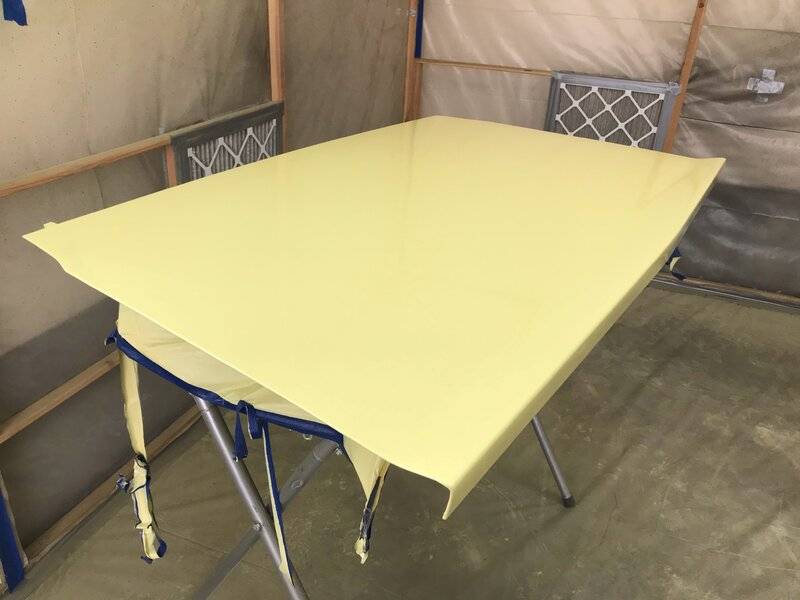

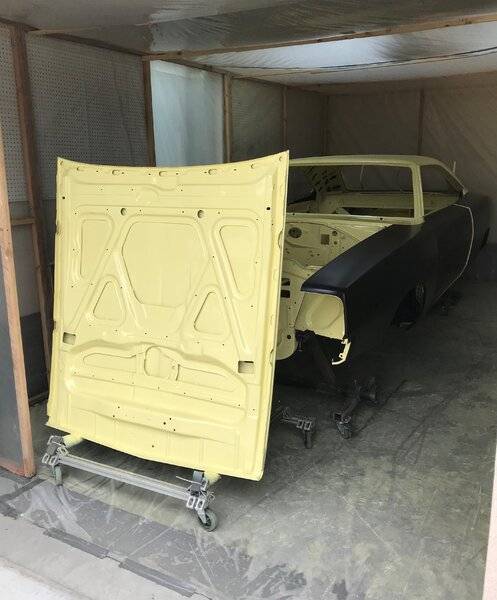

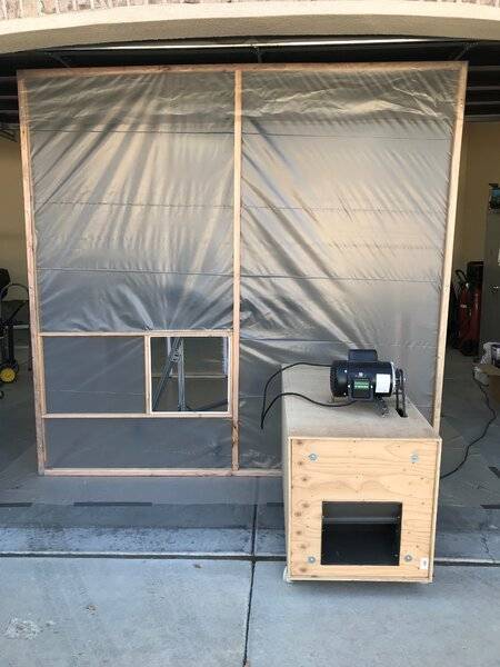

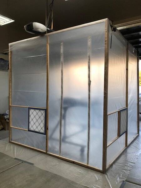

Also, I really like your paint booth construction. I'm going to copy it on my next job instead of stapling the sheeting right to the walls and rafters. Smart!

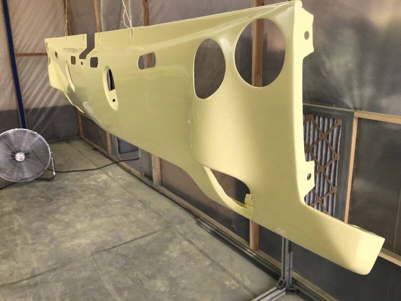

Can you post a link to your paint booth?

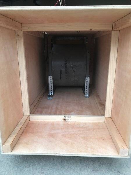

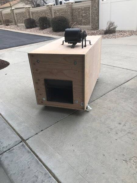

Basically the construction consists of 2 x 2 x 8 & 1 x 2's some deck screws and some angle brackets. I designed them to be 8 x 8 modular panels that are bolted together where you can make any size booth you want but be able to break it down and store them. The blower unit was constructed out of plywood and some 2 x 2's. The squirrel cage was salvaged from a scrap pile and rebuilt with bearings and such. The reason I built the blower with the motor outside the box was because I didn't want to spend the big bucks on an explosion proof motor. The motor I got from Harbor Freight ( 1 HP farm duty). Everything worked well, nothing blew up, I'm still vertical and my garage doesn't look like I painted anything let alone a 17 foot car. Paint came out great with minimal nibs so overall I'm happy with the way it turned out and I wasn't out 25-35 grand on a paint job...win win
