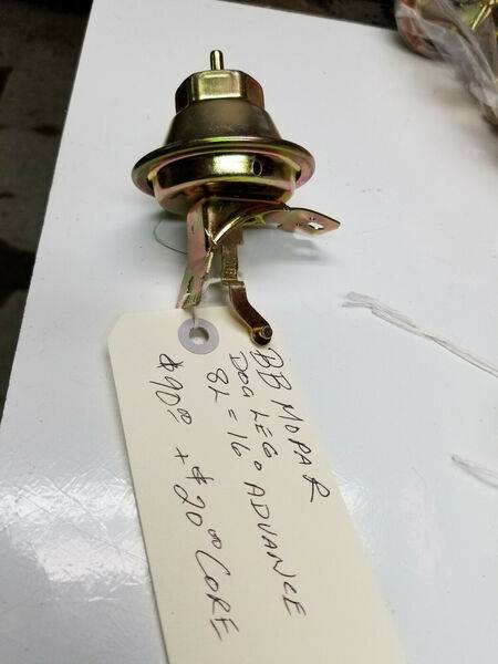

Two different arms on the big blocks. One goes strighter which you need and one is dog legged toward the shaft. I will get some pics of the difference.

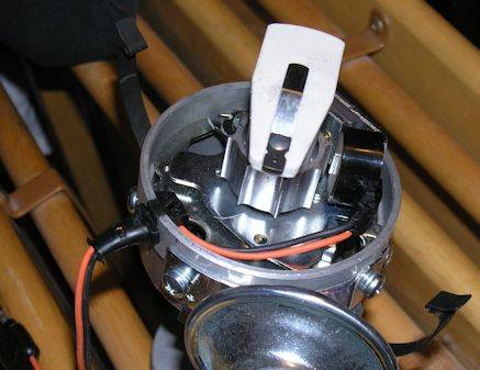

Mallory BB distributor... if you pay attention to the detail the vacuum arm goes inwards and you can see the pivot end of the vacuum arm down the reluctor, just right in front of pickup coil
same than the stock one
there is no way you need a diff vacuum with the pick up advance plate provision toward to the shaft. Vacuum pod arm goes inward

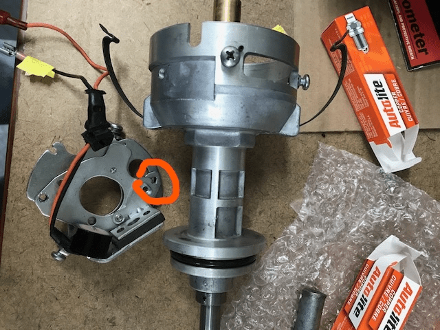

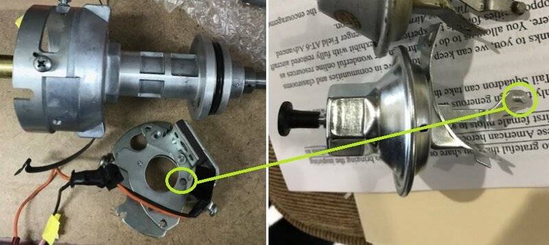

Unless I rotate the advance plate 180 deg I don't think I can utilize that hole. Here is the hole that seems to be in range of the vacuum advance arm. I marked everything with a sharpie upon disassembly to keep everything straight since it was an unfamiliar distributor to me. The wires and grommet won't reach if I move everything 180 deg but I'll study it some more. An older vacuum advance unit I have from an aluminum points distributor seems to line up with the hole perfectly - it has an arm that kicks out instead of in. It's a pretty old unit though and I would like to have a better replacement.
Maybe the points plate was mis-indexed by the prior owner who assembled this mess - I'll see if the grommet can be slipped and the wires adjusted.
