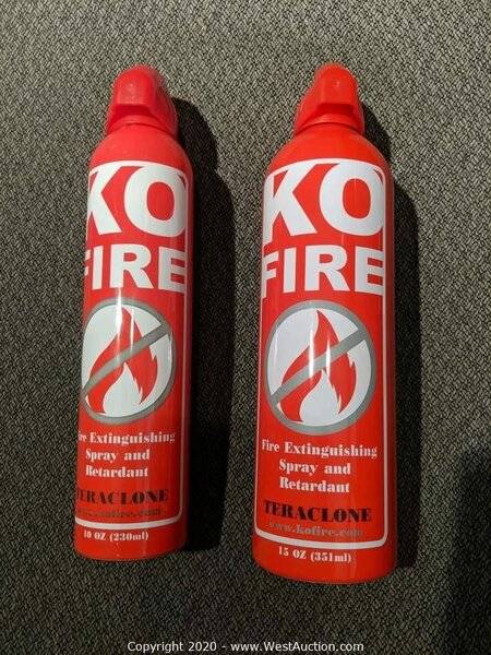

I've got one of these in every car, small and inexpensive.
