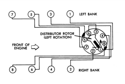

The firing order on my 383. Were is #1? In relation to the "notch" were the cap fits into the dist,colckwise or counter clockwise were would #1 be---------thanks
As Kiwi says, the dist doesn't have a specific spot for no.1, it's the physical position of wires in relation to your engine so all the wires reach the plugs that counts. The pic shows what you need. Big block distributor turns anti-clockwise.
If you are still running a factor intake firing order and distributor rotation is shown on the #7 intake runner. 62 Dart why the small block drawing?

In reference to drawing in #3 guess they do not know the distributor sets to the front of engine. To the last post the rotor pointing 180° off would not necessarily be a correct assumption as it all depends upon the distributor drive installation. Also the crank turns 2 revolutions to 1 cam. Just because the crankshaft is indexed to 0 it could be on eather the intake or exhaust stroke. The crankshaft slot needs to be to point where ever initial timing needs to be on the compression stroke. If the engine was running before and the distributor undisturbed the rotor will point to number 1 terminal at the cap regardless.

Stock distributor #1 tower clockwise from cap clip. 62dart's picture is valid. The two black areas around the cap portray cap hold down clips.
Dist. Vac. advance pointing forward of #1 cylinder (kindasorta).
Aftermarket distributors may not be indexed the same as stock.
