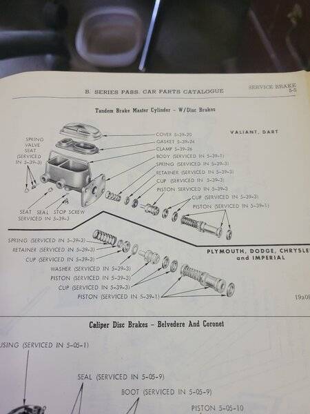

Oddly enough this is in the 66 parts catalogue

Oddly enough this is in the 66 parts catalogueView attachment 1169209
What catalog is that? Certainly not the standard 1966. I have it here and no signs of that. The spelling of catalogue tells me it’s something different.
Ha! Never thought of that. Yes it's likely a chrysler canada book.. (in canada) I'll check tomorrow
